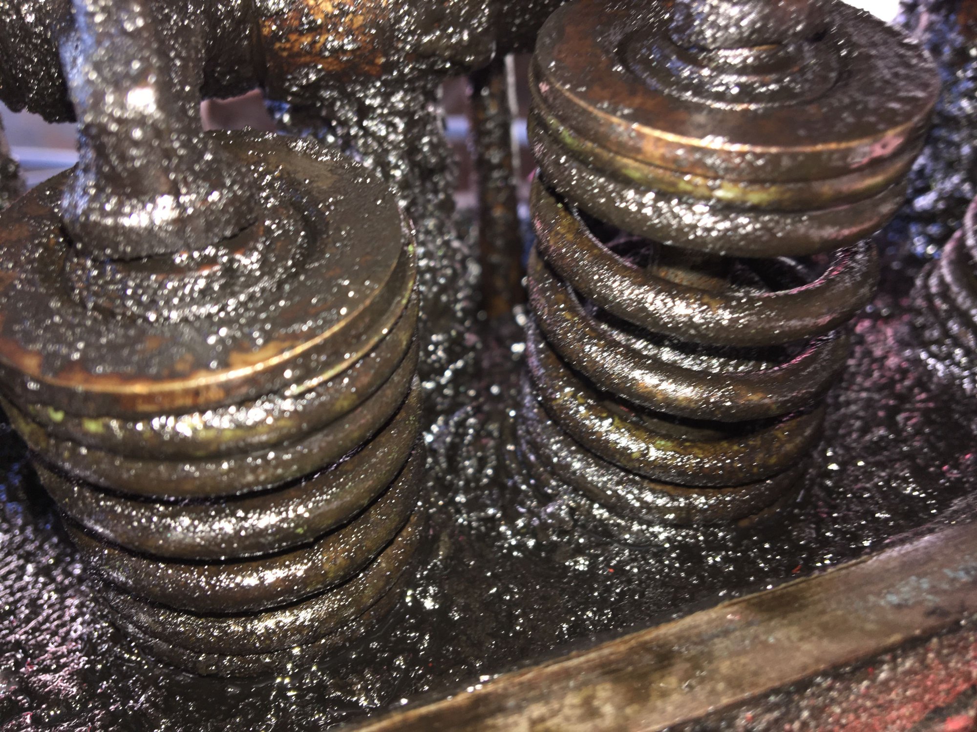

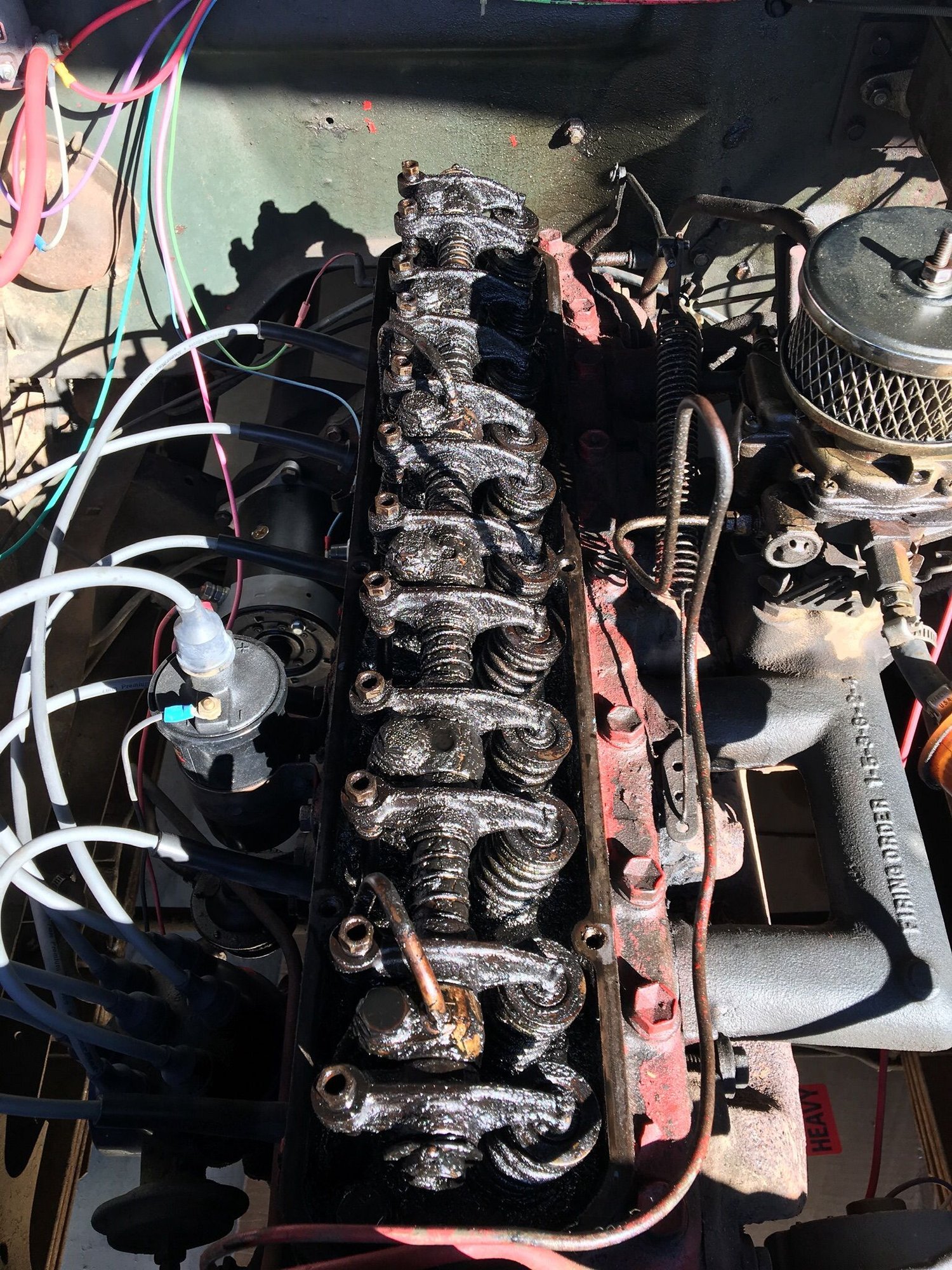

How bad is this sludge? Any pictures? What's the mileage on the engine?

not sure how bad sludge is but I expect it to be bad. I think it's been throwing oil out of the valve cover - I did pull the cover off and looked and it's pretty gunked up. I have pics but need to figure out how to post on this site. Mileage says 140K but I can't be sure that's accurate.

Let's see if this photo posts

Another view

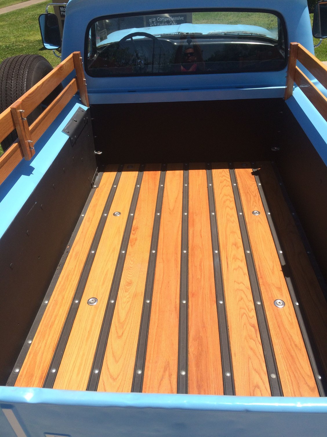

This is why I'm keeping it though...

Wow! That truck looks awesome! I don't believe you have more into it than it's worth, just rebuild the engine and get that thing back in the fight!
Hey will you shoot another pic or two of those wood side rails? They have a great look, something like that is on my project list.

T
John - this is the only pic of the rails I had in my photo album. I will snap a couple more when I can get down to my shop in a day or two. It's an easy build. I used red oak and stainless hardware. Same wood as the bed.
