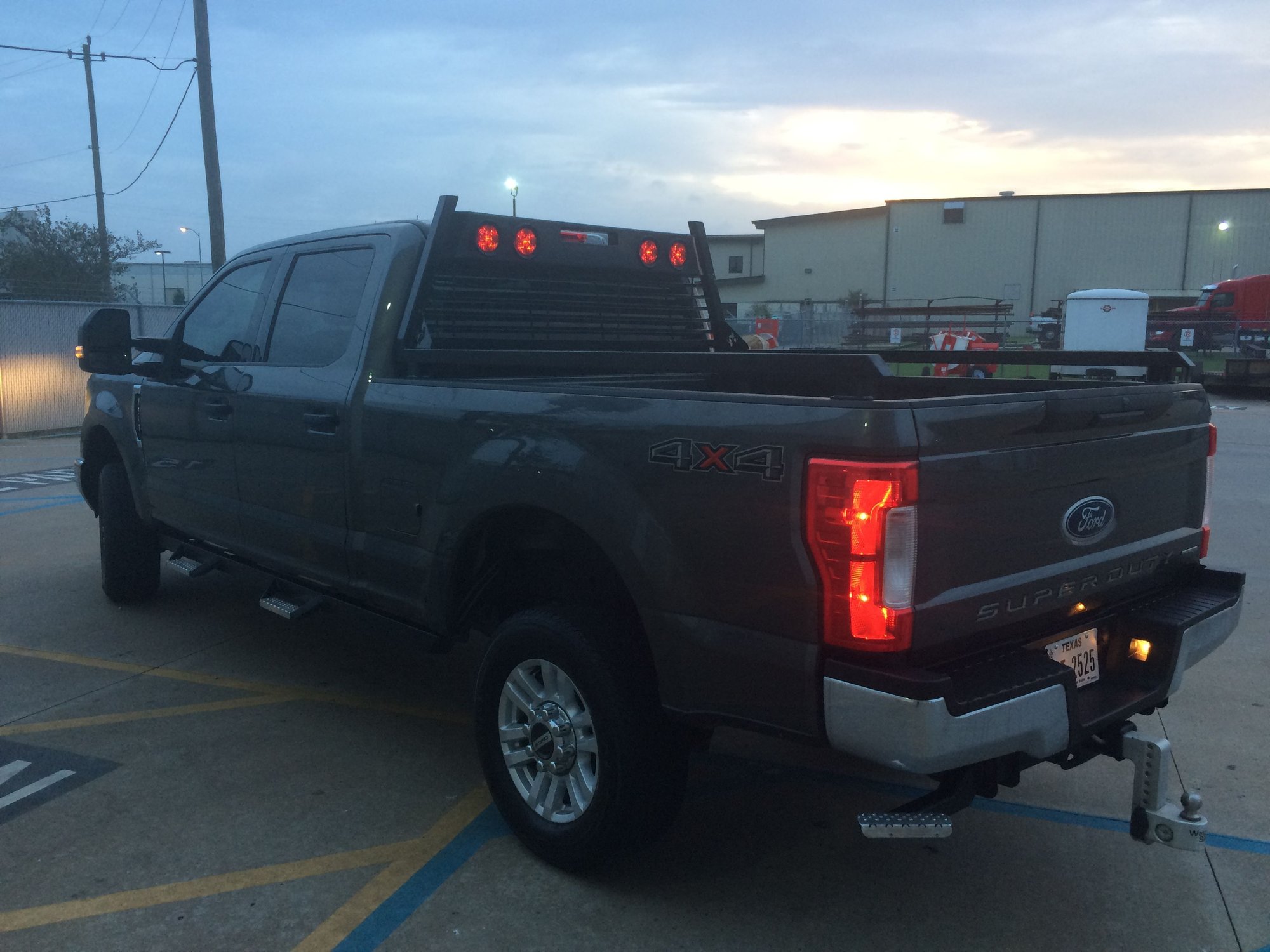

Crappy pic, but this was taken the evening I got my headache rack mounted. I could not see the point of spending $100 for the adapter cable. I simply pulled the taillights, tapped into the needed wires, and used a fai amount of splicing tape, Loom and zip ties to follow the factory harness back to to front of the box. No issues yet, it’s been two weeks.
