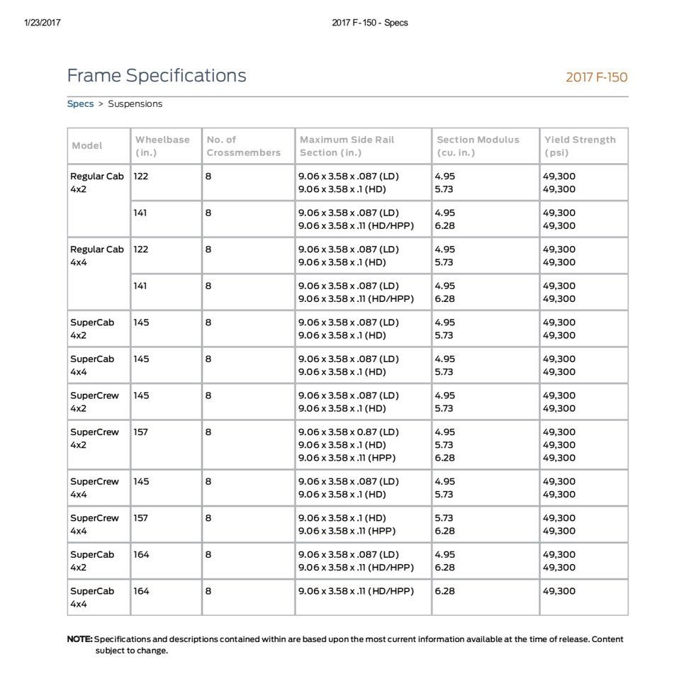

Originally Posted by Labmaster02
The frames are .100 for HD and .110 for the HPP for the 157" WB.
I have an 18 Max Tow with 20’s and have an HPP frame at 145WB.

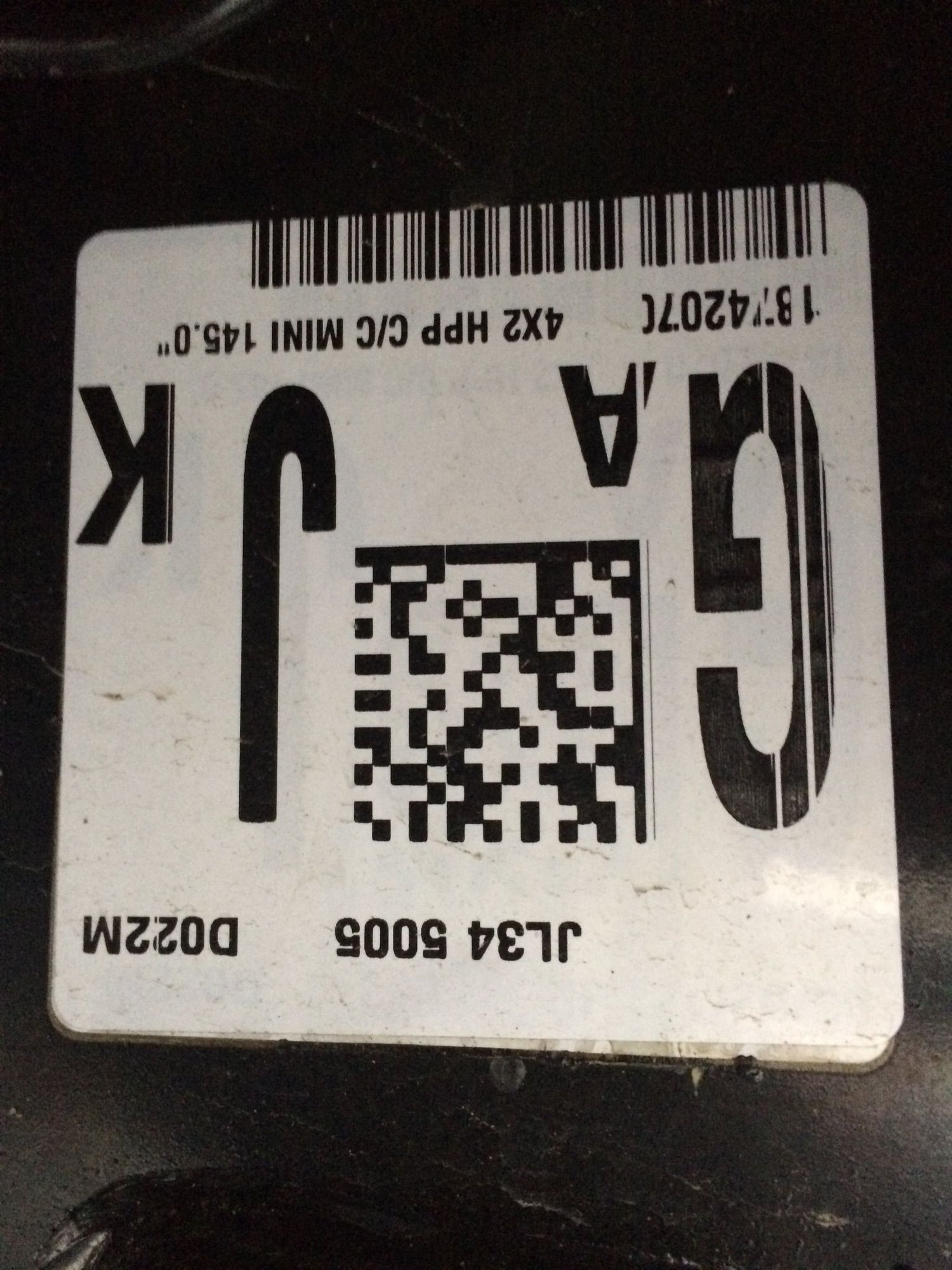

Curious. That combo (145" and HPP) don't appear in that chart. HPP only shows for 141", 157", and 164".
Old Nov 6, 2018 | 11:25 AM
Atrrider's Avatar
Atrrider
Joined: Oct 2018
Posts: 64
That’s also a 2017 chart. The truck is a 2018. It’s not a mistake in printing as I saw another one while I was searching.

So post up a picture of the frame sticker. It would help us keep track of frame codes when people ask in the future.
Old Nov 6, 2018 | 11:47 AM
Atrrider's Avatar
Atrrider
Joined: Oct 2018
Posts: 64
