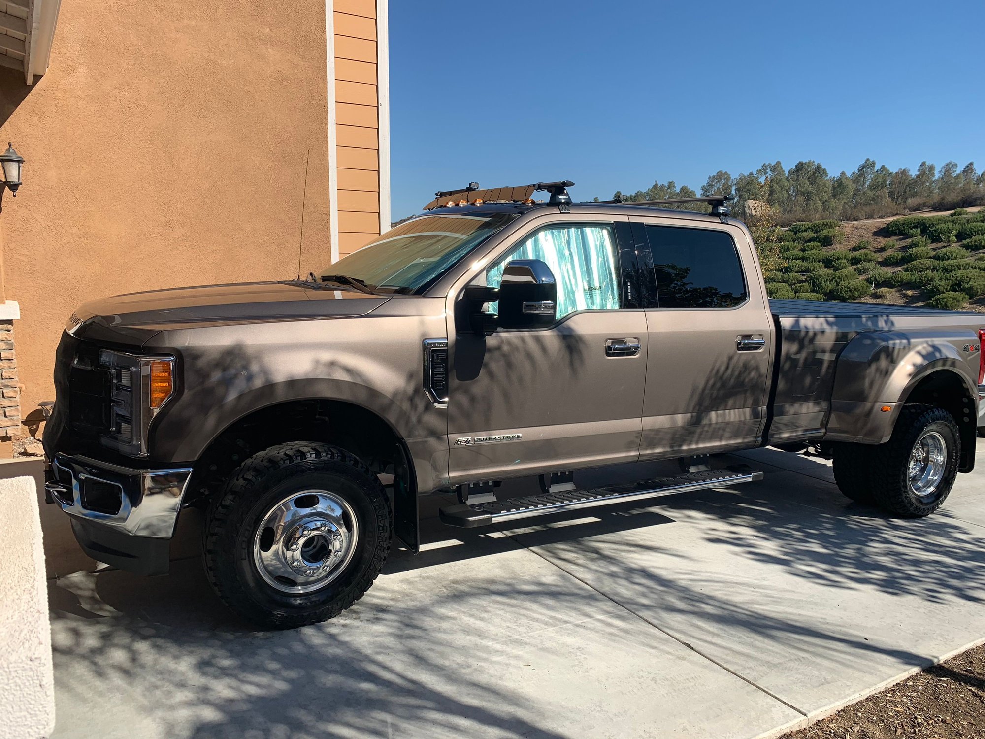

Old Nov 11, 2018 | 05:57 PM
07Wolfie's Avatar
07Wolfie
Joined: Feb 2012
Posts: 72
I carry a 12’ kayak on the roof rack when I’m towing the fiver with room to spare, and a 19’ kayak other times. The Yakima Baseline towers grab pretty solidly and wedge down into the drip groove thing on the roof.
Old Nov 12, 2018 | 09:26 AM
ExtremeDuty's Avatar
ExtremeDuty
Joined: Oct 2018
Posts: 486
From: Spring Creek, Nevada
Thanks for that. I'll be going the same route.
