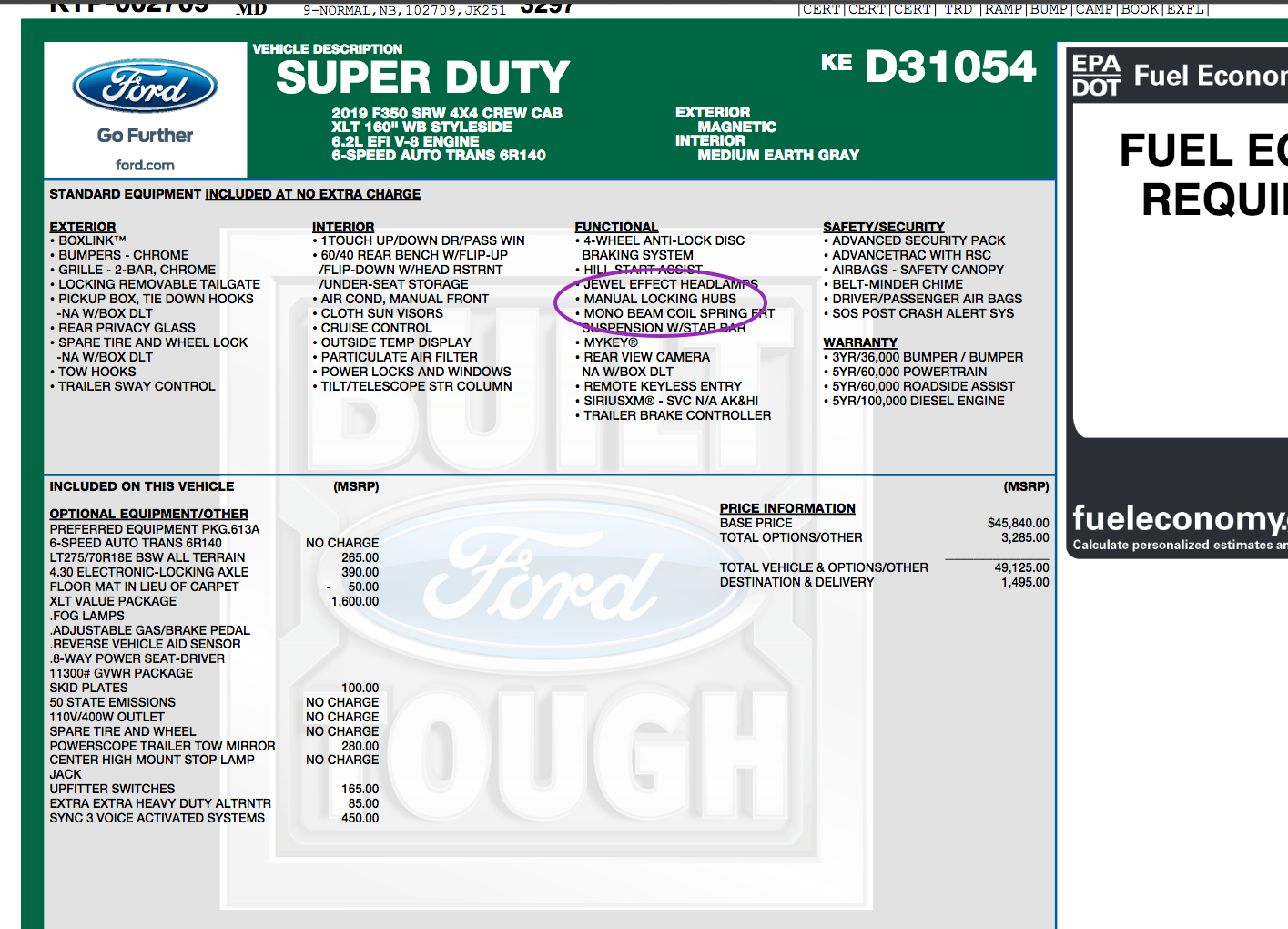

Finally just had my window sticker become available on my F 350 special order. I searched a little and couldn't find the answer...sticker has "manual locking hubs" listed. How do the the front hubs work on these trucks when switching to 4 wheel, do I have the coveted option of using 4 wheel low with the front hubs unlocked and freed up for sharper turning?

Spleeft, for 2018 Electronic Shift on the Fly (ESOF) became standard on 4x4 models. You can still "option" for manual shift on stop at no cost if you desire. However, unless you specifically order that system which includes a manual shifter on the floor for the transfer case, you will be getting the ESOF system with a **** on the dash to switch between 2H, 4H, and 4L.
The "manual hubs" portion has always been part of the "standard equipment" of an XLT. But since I don't see the option for manual transfer case shifter, you'll be getting the ESOF which does not allow you to use low range while in 2WD. However, note several users have found ways to do an easy mod to allow this with the ESOF system.
Your hubs will be auto-locking but you can still manually "lock" them at the wheel if you choose. The purpose is so you can still have 4x4 if the auto hubs ever fail.
