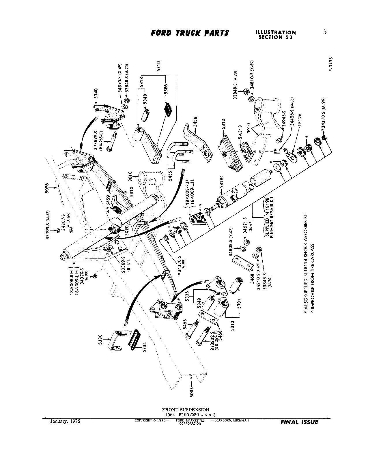

Third: There is a loud popping noise during harder turns, I think it is body flex. Would new rubber (or polyurethane) body mounts fix this and how hard are they to install?

Take a good hard look at all of the bushings, radius arms, I-beams, spring shackles, cab mounts, engine mounts, steering linkage. Check your king pins.
Those are things that can contribute to the poping noise.

I've found that popping in the front end is often related to worn out leaf spring eye bushings. Once they wear to a point they allow the leaf springs to "shift position" when taking corners. Take a left corner and things settle that direction and then you take a right corner and everything can suddenly shift the other direction causing a popping noise that you can hear and feel. Probably not the only cause, but I've seen it with the old leaf spring front suspensions a lot.

agreed on the spring eyes. the one I drove back in the 70's (HS) had one eye that the entire front rubber bushing had rotted out. the spring flapped back and forth horribly and makes for quite a racket.
I had the front of my current one rebuilt early on and it went from a swaying, creaking, clanking old war horse to an absolute pleasure.
I don't think the shocks often make that sort of sound unless actually broken, but the bushings there also wear out over time. checking those as well surely couldn't hurt.
