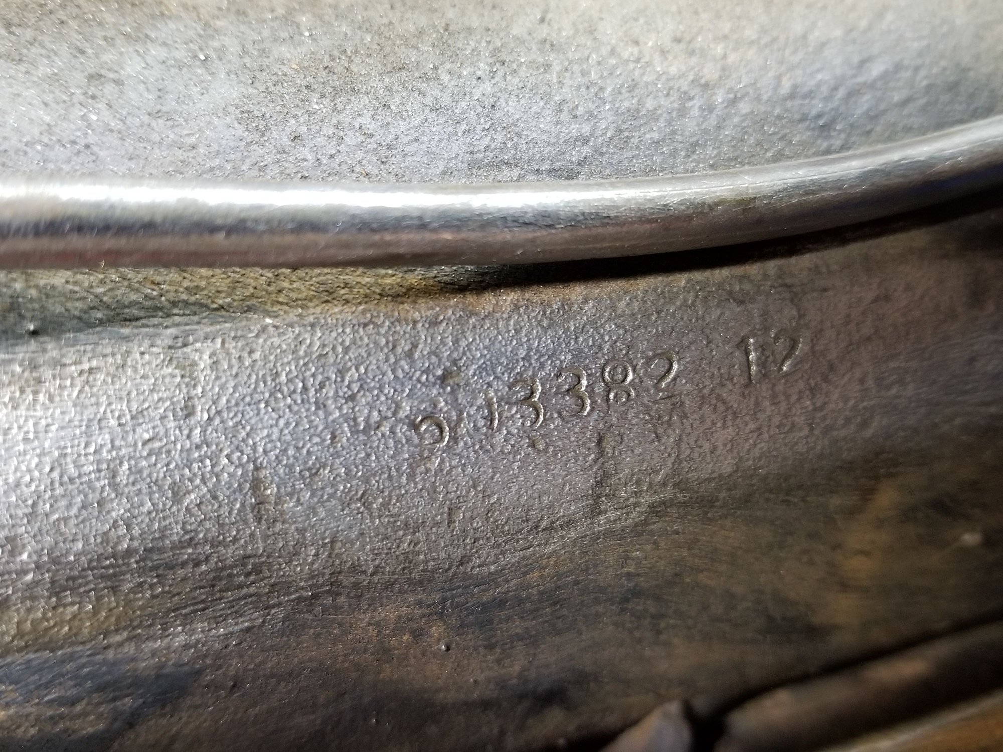

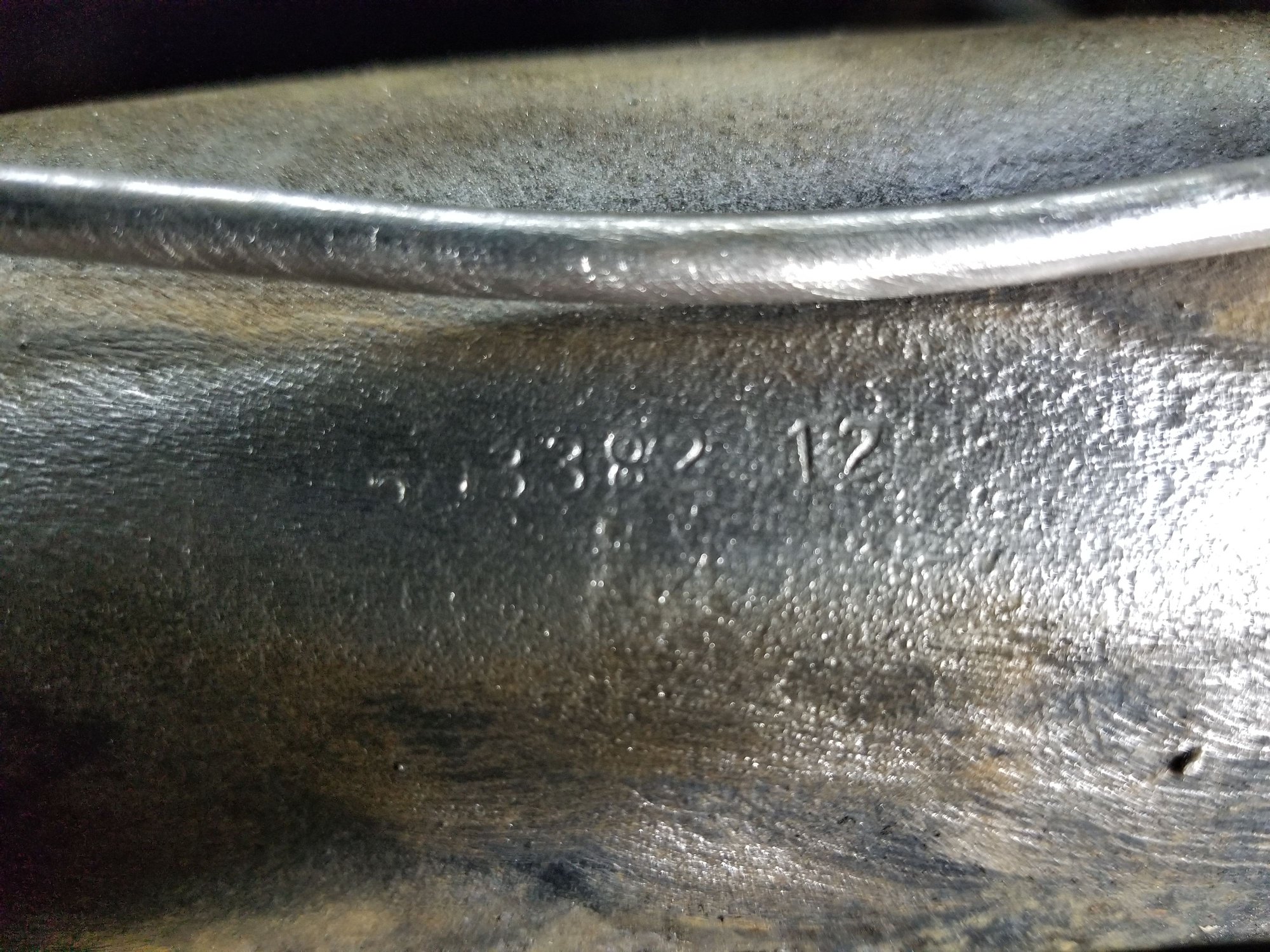

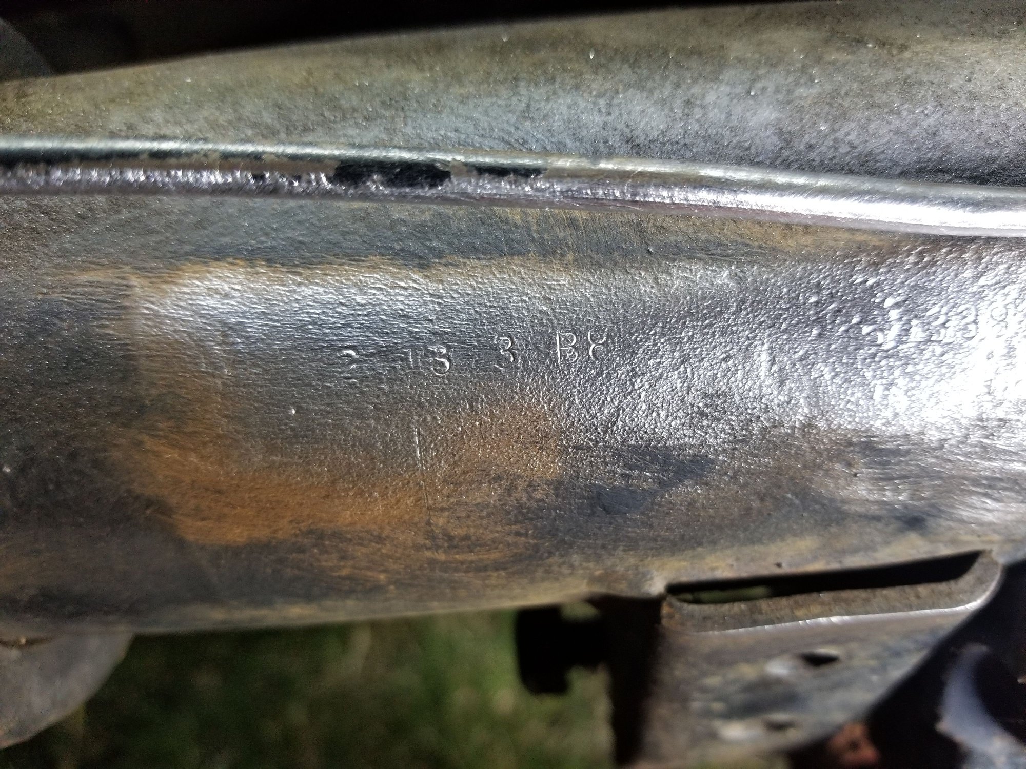

the truck was sold as a cab and chassis in Charlotte NC and sent to the body company to have the body added. I have included the drum hub and BOM numbers pic

if i did my research correctly the axle is a dana 60 with a 4:10 ratio .

Yes that's a 4.10 D60. However the extended wheel studs are not stock. Pretty risky running duals with a single lock nut. Good news is those hubs are easy to get from another D60. The D70 hubs will not fit from a F350.
