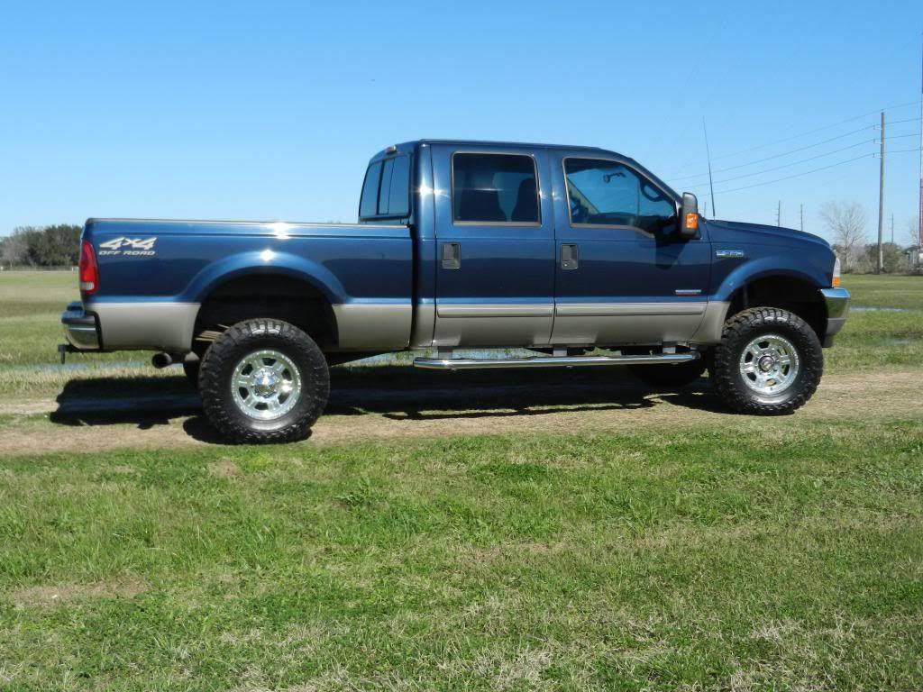

I put an Icon 4.5" lift on my 2002 F250. I was really happy with it. It had 17x8.5 wheels and 35x12.50 tires on it. It used spring hangers and blocks, so it wasn't affected by gas vs. diesel springs. It was an easy install too.
That’s a great looking truck. Did that wheel tire combo rub at all? Remember what offset that wheel was?
I "believe" they were 4.5" backspacing on a 17x8.5. I haven't had that truck in nearly 10 years now, but don't recall it rubbing the leaf springs. I know it didn't rub anywhere else. The wheels were Weld X-Landers if you can find any info on them. They have been discontinued for a while now.
