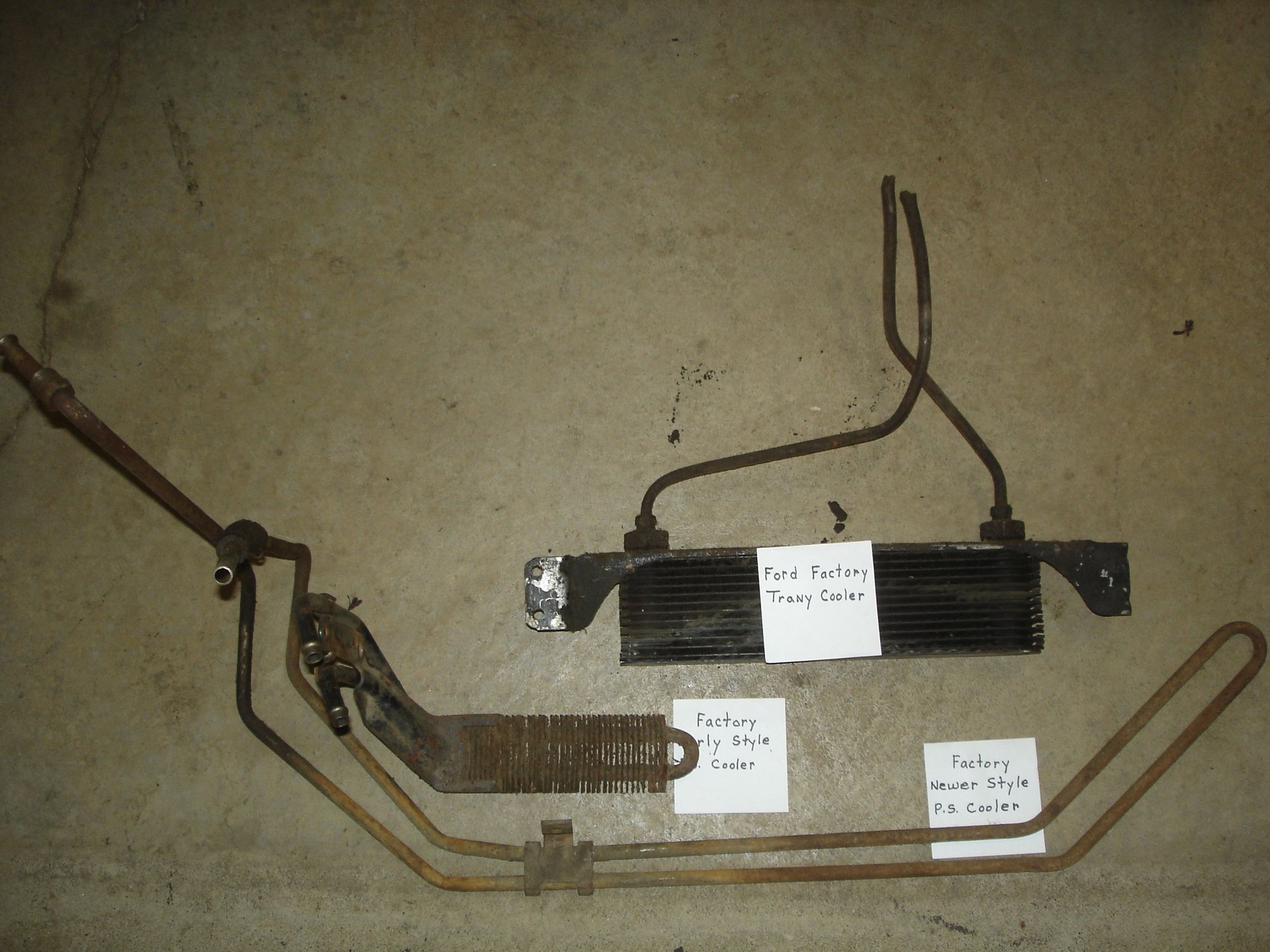

Pic: Genuine Ford Trans Cooler, usually dealer installed.
D4TZ-7A095-A = 1973/74; D5TZ-7A095-A = 1975/79

From: East Central Ia
That's a great pic, the first one I found and bought, I took the lines too. Makes since for dealer installs too. Lines slipped right into place and put it in series with factory radiator cooler no splicing or adapter fittings.
