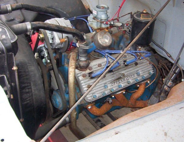

As far as I can tell the water pumps from a car are different than the truck ones correct? This 239 in the 53 we are doing running into an issue on the crank case breather tube. If I mount the one that I think is the one for it it hits the water pump pulley and the ear on it. From what I have been able to gather is that this motor is not original to this truck. I am thinking it came out of a car and thats the reason for the different water pumps. Am I thinking correctly? The other pipe I am holding is one that came with this truck in boxes. Not sure if it came on this motor or is missing more of it. If we put that one on then it drops to the inside of the left water pump and exits about the middle of the block. Appears it would clear everything as far as belts and pulleys but not sure about the exiting so high. I know it would not be original. Its either that or customer has to buy a pair of water pumps. Any other ideas?

The draft tube on the engine looks correct, the water pump is not. The '53 truck water pump has the wide pulley and no engine mount.
The "before" picture below shows the draft tube in place. The "after" picture shows the pump.

Lower picture: 1949 Ford Passenger Car & 1953 Ford Truck 239 water pumps: 8BA-8501-G Right & 8BA-8502-G Left = See post #3
