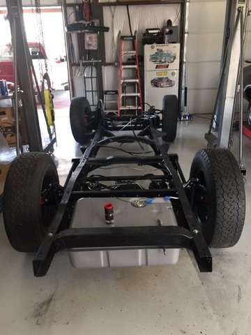

If you go with a Mustang tank and it will fit, use either a 1969(20gal) or 1970(22 gal). That is 4 or 6 more gallons then the 1965-1968 16 gal tank. They are the same size side to side and front to back. Just instead of being flat(level with the flange/seam) on top they are taller. That's what I've put in the '66, '67 & '68 Mustangs I've built. More driving range.

My understanding is it fits between the rear frame rails and the lip of the tank site on the frame rails. I believe it requires the spare tire to be relocated. If when sitting on the top of the frame the taller '69 & '70 tanks would not clear the bottom of the bed you could likely mount it on the bottom lip of the frame.

What year mustang tank has a 22 gallon capacity and electric fuel pump? I considered a mustang tank but models I looked up were only like 16 gal or so. But I didn't look too hard after I saw the smaller tank. I was hoping to go with a tank at least 20 gallons. I was going to attempt a bronco tank between the frame rails but haven't had time to work on that angle just yet. I have a 95 F150 with a rear tank but I think it is a 19 gallon and I would really like to go bigger. I have to stop for gas too much as it is. If I could squeeze a 25-30 gal tank under my 65 it would be great! Just afraid a tank near 30 gal would hang down too much?
My '86 has a option for a 38 gal tank but I chose to go with the 19 gal and keep my spare mounting onder the tank...the 38 gal you loose that option.

I relocated my fuel tank which I purchased from LMC. I did not use the straps but bolted it directly to the frame. Make sure you think the bolting through in vase you need to remove the tank for some reason because once the bed is on, it becomes much more difficult to remove.
