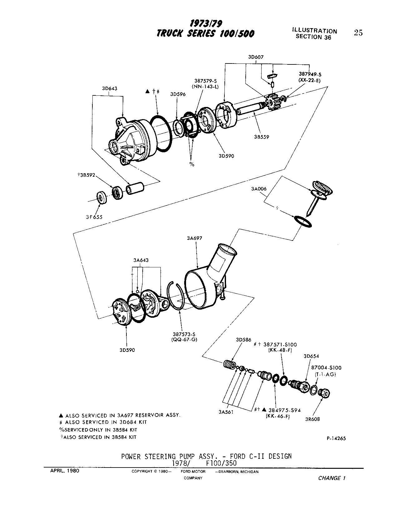

1978/79's used the Ford C-II P/S pump, the brackets are specific to this pump, as it's a different shape than the Ford/Thompson P/S pump used 1967/77.
The Ford C-II P/S pump has a plastic reservoir. The P/S pressure hose attaches to the pump w/a qwik connect fitting.
No 351W's were factory installed in F150/350 & Bronco until 1981.
Pic: C-II P/S pump:
