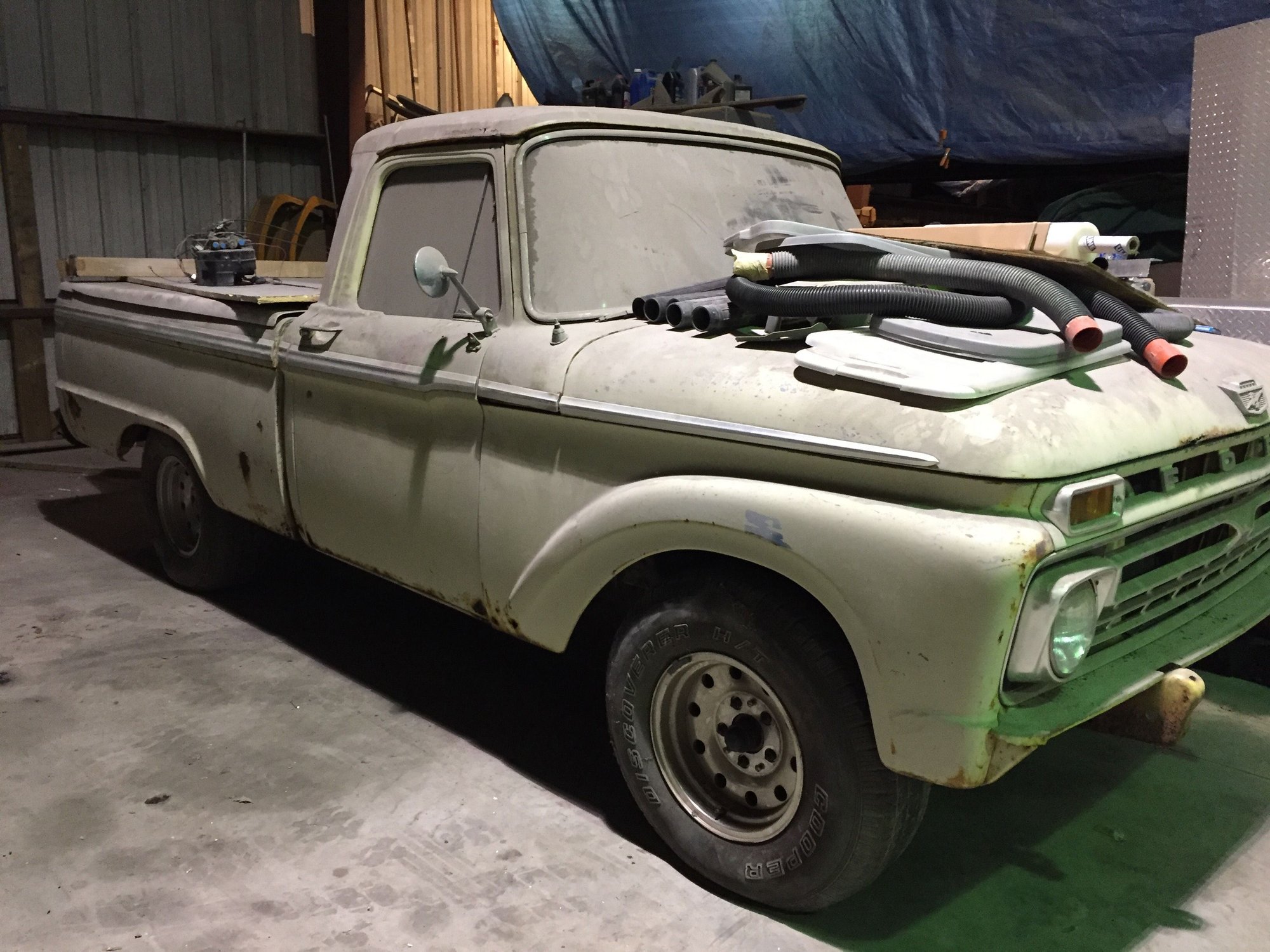

It's on! We finally found a project to restore. A '66 F100 we bought from a friend of ours who has had it for 25 years. He'd been collecting parts to resto it with his daughter. But she's grown, married , gone and no longer interested. Poor dad, lucky us! :-)
Dusty, rusty and ready for a makeover!
Original 352 Big Block, No leaks anywhere! 92k miles original.
The neighborhood loves us now...no garage to work in...
Not sure of the original color, lots of blue and yellow going on here.

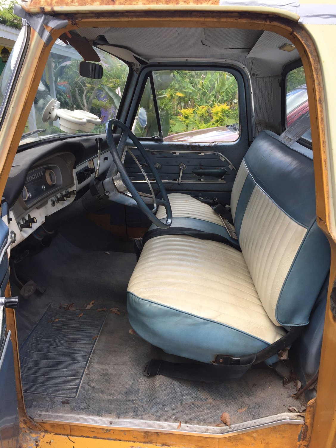

Any suggestions for a shorter steering column? This big momma is snug behind it. Steve put a '76 steering box on it so that's what we need to match unless there is a '66 automatic steering box I could find somewhere. Suggestions?

Looking forward to seeing the progress! What was attached to the windshield inside of the cab?
