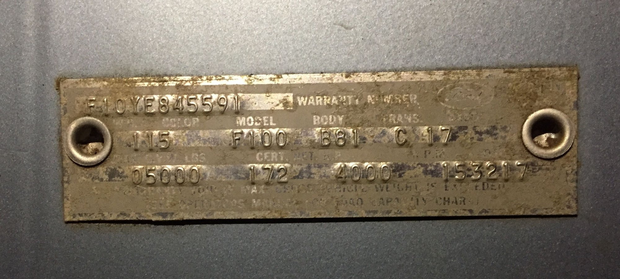

Old Sep 29, 2018 | 01:55 PM
missrankin's Avatar
missrankin
Joined: Sep 2018
Posts: 17
Originally Posted by 65navyf100
Looking forward to seeing the progress! What was attached to the windshield inside of the cab?
65navyf100, that’s a sea sucker. Great cup holders, bike racks, etc. made right down the road from us in FL. Www.seasucker.com. It’s for the boat usually but we had it in the cab for a bit. 😎

My guess on the original colour is Chrome Yellow paint code G. It is the colour of the drivers door frame and the underside of the box. The interior has been sprayed blue because you can see the yellow underneath. The outside yellow could be primer or faded springtime yellow.

The gas tank is blue. and the floor mat is original and it is blue. Also, on the outside, like the hood, the paint is peeling and revealing blue. I'd tend to guess the body code is B81 judging from the floor mat. I suspect the original paint job was blue and that the interior has not been repainted.
Post a picture of your warranty plate and we can decode it for you.

I will anxiously await a posting of the warranty plate so long as the VIN matches the frame. In the meantime all the blue parts are bolt on. The truck is likely pieced together from several trucks as the door appears blue. The passenger fender from under the hood shows chrome yellow. The passenger side tail light mounting area shows chrome yellow inside. The blue does not appear to be a standard colour such as Marlin, Silver Blue metallic or the infamous Arcadia blue.

Brad, the firewall is and bottom side of the hood is blue and if you look at the picture of the engine and look close at the drivers side hood hinge you can see drips or runs of the yellow paint coming down the cowl over top of the blue. I don't really consider the firewall to be a bolt on part but it is true that the cab bolts to the frame so I guess in a way everything is bolt on.

Here's a couple of other clues - the picture with the full bench seat showing - if you look close there is blue peeking out from under the padded dash. I doubt anyone removed the cracked dash pad, painted it blue underneath and then put back the same cracked dash pad. However, this appears to be a Custom Cab and there is no Custom Cab script on the doors or holes where they were and despite it being a V-8 it has a 6-cylinder hood ornament. So the warranty plate might not be original to this truck.

Here’s the warranty tag, guys. Appreciate the decoding
