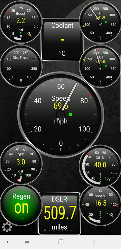

A little trick I noticed is under light throttle the boost will spool much faster during a regen. You shouldn't have any exhaust related issues until about 120-150k miles, which is the life expectancy of the DPF. Like you are saying it would be nice to know when a regen completes so we don't shut it down mid cycle. I have a lariat so I have the updated productivity screen which can display the DPF%. I check it regularly and when I get close to 85 90% full I leave that screen enabled. Once I hit 95% I plug in my OBDII adapter and fire up Torque Pro on my phone and monitor for a regen to initiate.

I have a '14 Lariat. With a Windows tablet and Forscan I can do a manual regen sitting in the driveway. Not sure what models you can or can't do a manual regen on though. I also enabled the dpf % screen using Forscan. I just keep the display up all the time. You don't have too look for the cleaning exhaust filter message to flash up. I just watch the percentage increase and when it's in regen the percentage will decrease.

My take on this is as Dirthawg mentioned, I'm in the "mostly local" driving camp. Yesterday I happened to notice the message flash up, wound up "taking a ride" until the regen finished. I have Forscan lite on my iPhone with the OBDLink MX WiFi and drive until it's done. I need to break down and buy a PC so that I can enable the %full screen as well as the ability to do a regen in the driveway. I'm going for the Titan 50 gallon tank once my current tank of diesel runs out so going to need to change the "miles to empty" PID to 50 gallon so something needs to happen soon. Went way off topic, if I want to make it to 2000,000 miles I'm going to need to manage my regens, when I used to go into the office and used the truck as a daily driver, didn't worry about it at all.
