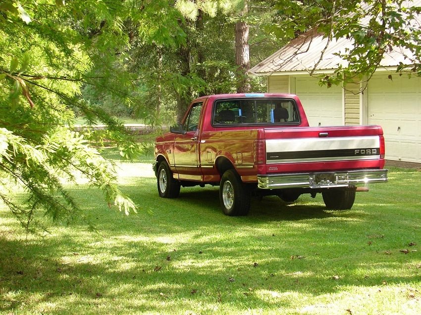

Now have doors that latch, lock & open inside & out.
Windows that go all the way up & down.
Still need a couple hinge pins or the rehabbed strike bushings will eat away. Again.
Starts own its own after 3 days of being off the charger. It's weather tight should it need to stay out in the rain.
Tint from hell is gone. Along with a few pounds of broken glass from the bottom inside of the doors.

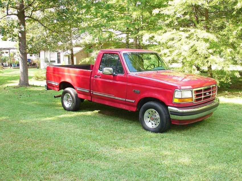

Well damn... had not realized how much I let this thread atrophy.
Has been parked & untouched since covid I knew for sure, but 2019 seems to have disappeared as well.
First off was the major discovery that the engine in it is not the correct cam/firing order that a 94 MAF 5.0 should have which I've mentioned I know in some other threads.
I basically threw a set of used FRPP wires & cap on that I had hanging on the wall from either my truck or GT that could have been installed blind folded.
It ran like crap after nearly impossible starting. Had a look at the wires & cap I took off (stock Motorcraft & numbered) still loomed & discovered a 302 firing order... WTF???
Changed the required # of wires to correct plugs & it's back to normal. (rough & pig rich)
