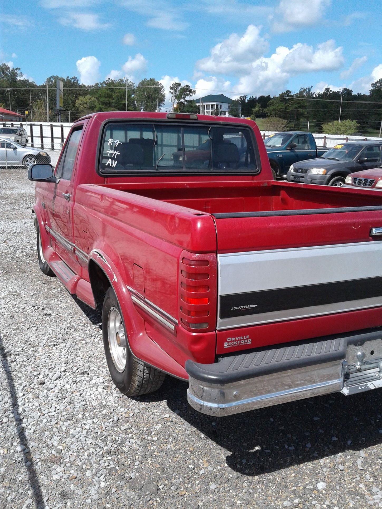

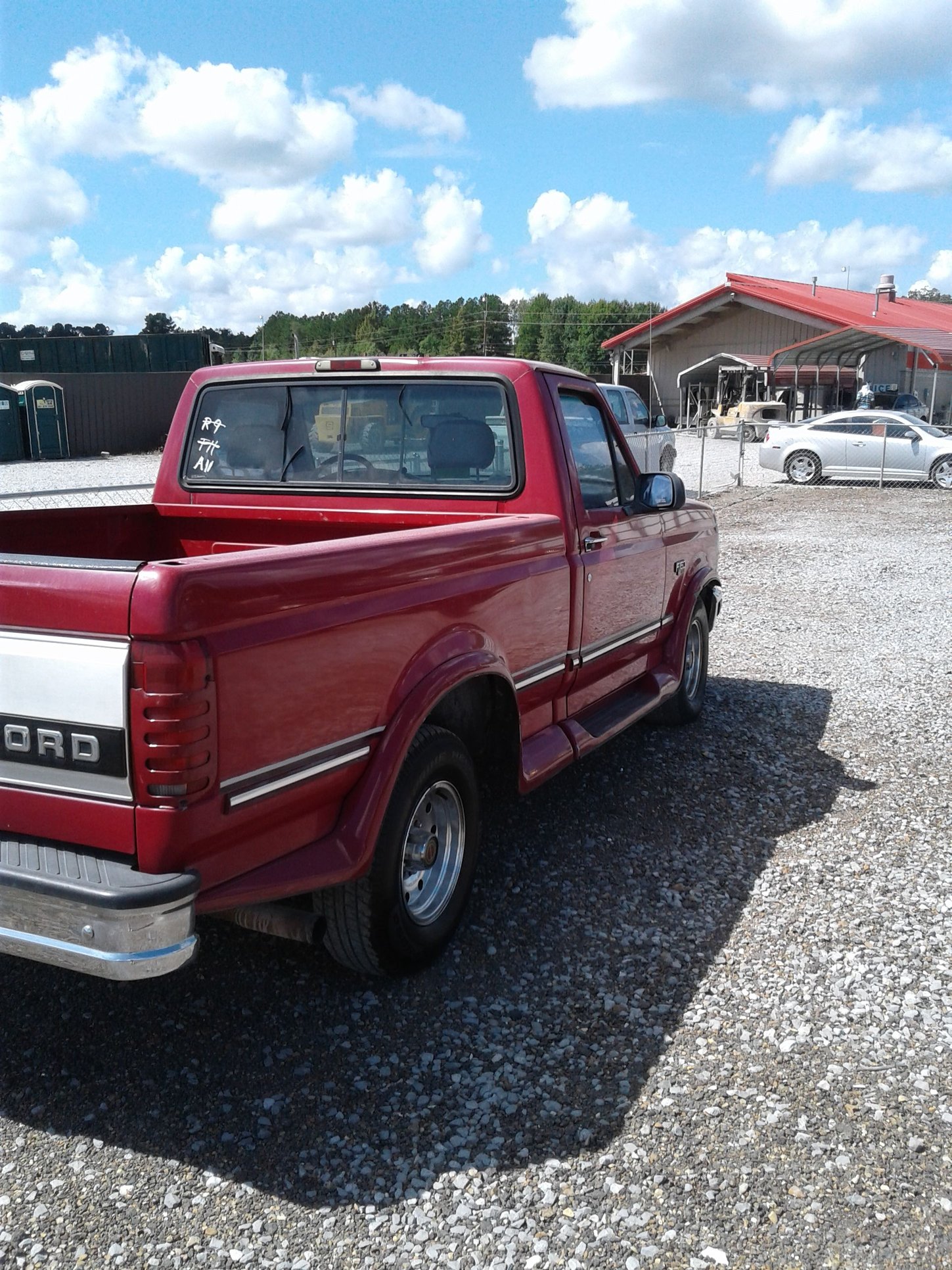

Picking this up this AM. 94 XLT (edited), 238K, 5.0/4R70, MAF Reasonably good shape despite the miles.
Runs rough when warm, shifts smooth, front end needs work.
Will see how it turns out.

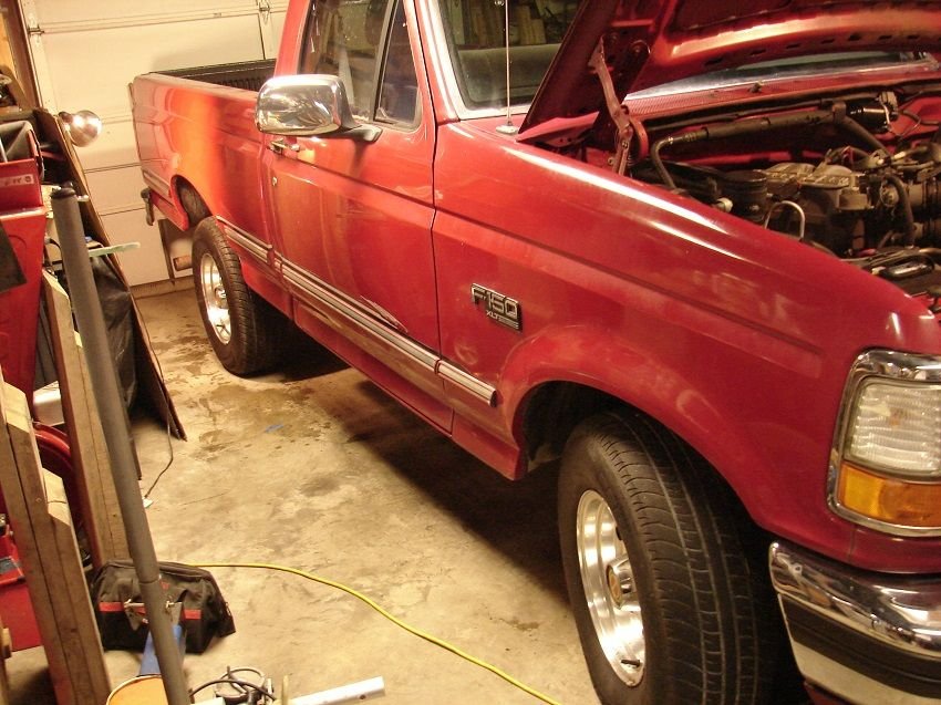

The short list:
Door pin/bushings. door strikes, remove night mare tint, remove ground effects, remove stripes, alternator, shocks, brakes, wheel cylinders, rear window seals, antenna cap, pass side headlight flooded, idler wore out/torx bolt stripped, front tank gauge, AB code 32/clockspring (horn/cruise), CEL bulb, 6 cylinder snorkle, window motor bushings, both sides, shampoo carpet/seat, plugs, headliner.
CM codes 334, 172
ER codes 116, 172, 334, & the ever popular 538.
Put my original 95 amp alt off the 5.8 on yesterday. Boosted out put from the "O" over to tween "M" & "A".
Cleaned out the distributor & PIP, scrubbed the bottom half, threw on a used rotor.
Cleaned IAC & capped the leaky CANP nipple.
Set timing to 10*-ish (giant pink mark on balancer), could be 12*
Noticeable improvement in run/idle.

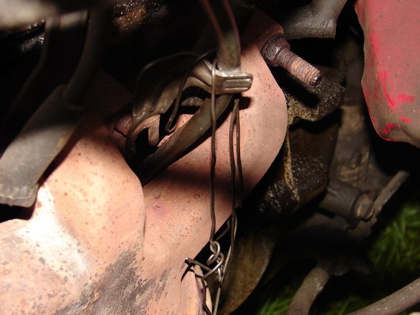

Below is day #1 first repair. dipstick tube was flopping around in hole since the stud is broke off.
Cleaned hole & threw a o-ring on it & wired it down:

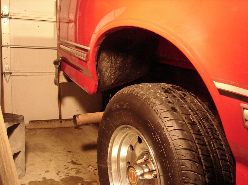

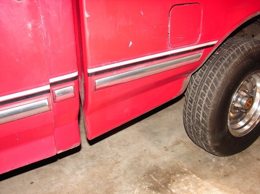

Pulled the damaged body kit off today & cleaned off the crud hiding.
My chapter bud pointed out that it probably blew a tire.
There's black & (yet) another dent on the bed rail to go with the above.
This sucker is definitively wearing some high-water pants...

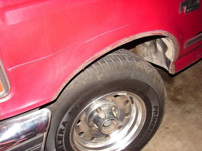

Pretty truck, but I noticed what looked like where it overheated and blew rusty water all over the engine compartment at sometime. Unless that is red Mississippi mud dust.
Old Sep 28, 2018 | 08:10 AM
Scndsin's Avatar
Scndsin
Joined: May 2006
Posts: 12,338
Likes: 1,314
From: Central Mississippi
Oh no, it ain't mud. It obviously self-flushed it's self sometime in the near past.
It has damn near zero rust save for surface scale on the frame.
I could only find one tiny smaller than a pin head spot in a wheel arch after pulling off the body kit.
Was really terrified it might be et' up.
Now the DENTS on the other hand are everywhere.
Thomas, it does look tons better without.

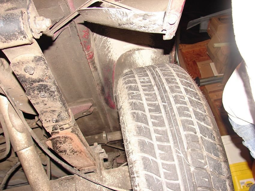

Just don't know what to do with that "*** in the air like a cat ready to mate" stance or why it's there in the first place.

That looks like an aftermarket helper spring in the back. Could be pushing the rear end up. The leaf on the bottom of the pack. If it is thicker than the others it is most likely the culprit. Add-a-leaf
Old Sep 28, 2018 | 08:34 PM
Scndsin's Avatar
Scndsin
Joined: May 2006
Posts: 12,338
Likes: 1,314
Thanks, I was going to compare the # on my super cab tomorrow.
