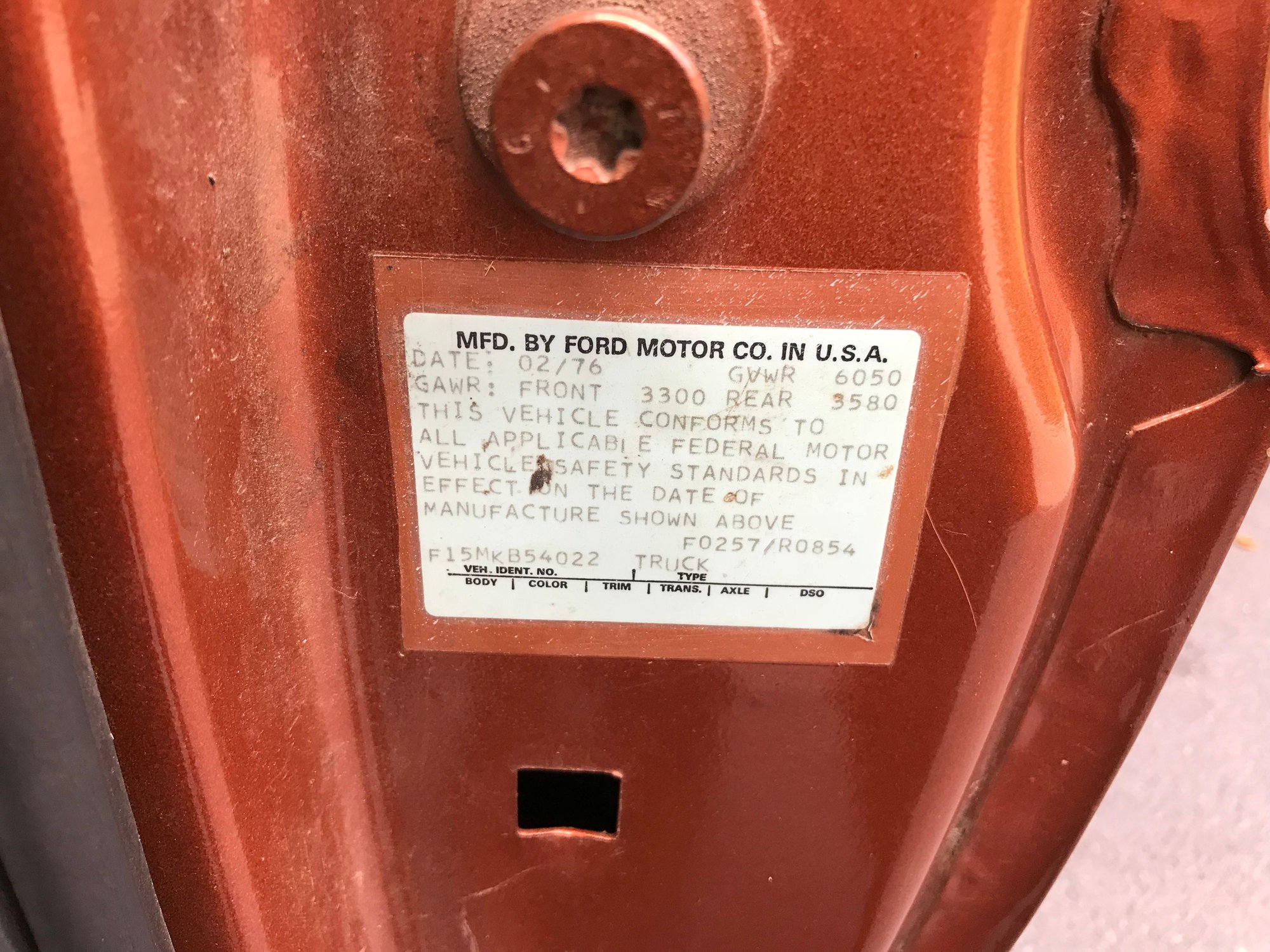

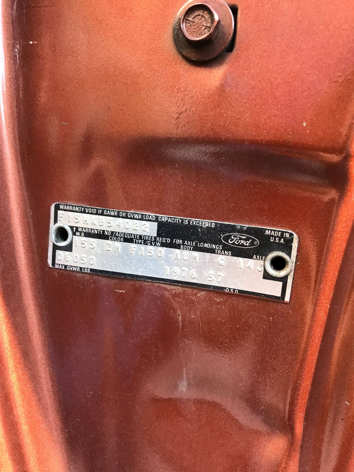

The VIN numbers on the door and the pillar do not match.
Have the doors been replaced or the cab? A little more research would be recommended.
How about a few pics of the engine.
Ben
Ben
They do match the door tag is not clear but the vehicle sequence number is the same.

The engine code on the door looks like an H and the pillar engine code is definitely an M. What do they look like to you?
Ben
Ben
Looks like M in both spots. It's a very "H-ish" M but an M all the same.
Ben
The Aluminum tags are notorious for mis stamps and stamping errors, the biggie is the sequence number is the same on both. And only one dentside truck would have that B54022 sequence number.
As for the engine codes M is a 390 4bbl and H is 390 2bbl. So either way it is 390. So someone punched the wrong 390 code for the aluminum tag.
Also the Aluminum tag is stamped for a 1976 as is the certification label.
It is not uncommon to find mistamps and errors on the aluminum tags a good 1/3 of aluminium tags have stamping errors..,
