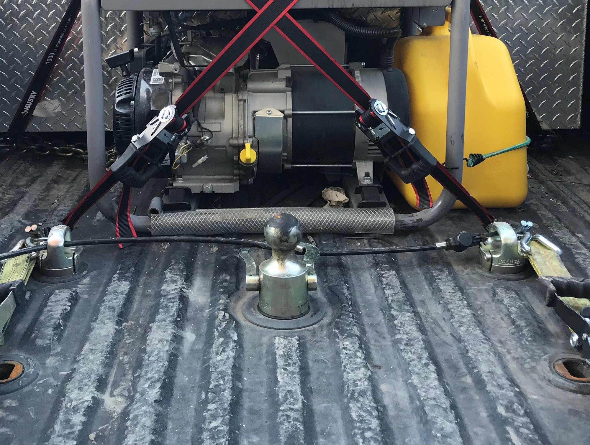

I would suggest the Reese GooseBox and the B&W ball. From what I’ve read, the Reese GooseBox is the only gooseneck hitch that doesn’t void your frame warranty.
" I would suggest the Reese GooseBox and the B&W ball. From what I’ve read, the Reese GooseBox is the only gooseneck hitch that doesn’t void your frame warranty."
I believe that to be an incorrect claim. The Anderson pulls straight from the pin, not from a lever that's 2 feel lower; that leverage is where 5vr frames (may) get bent.
