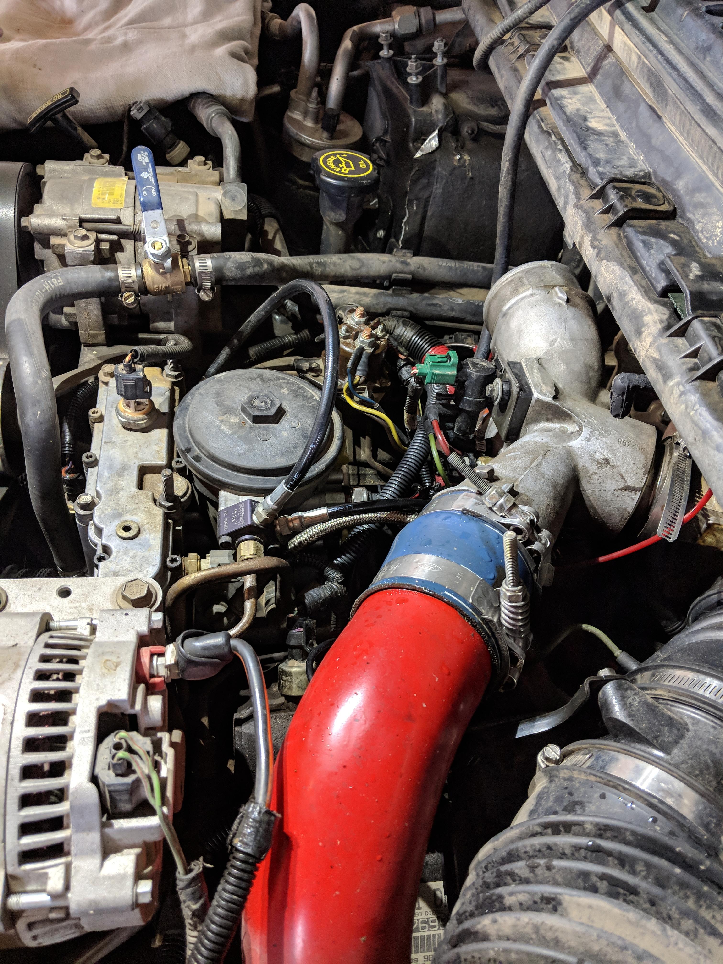

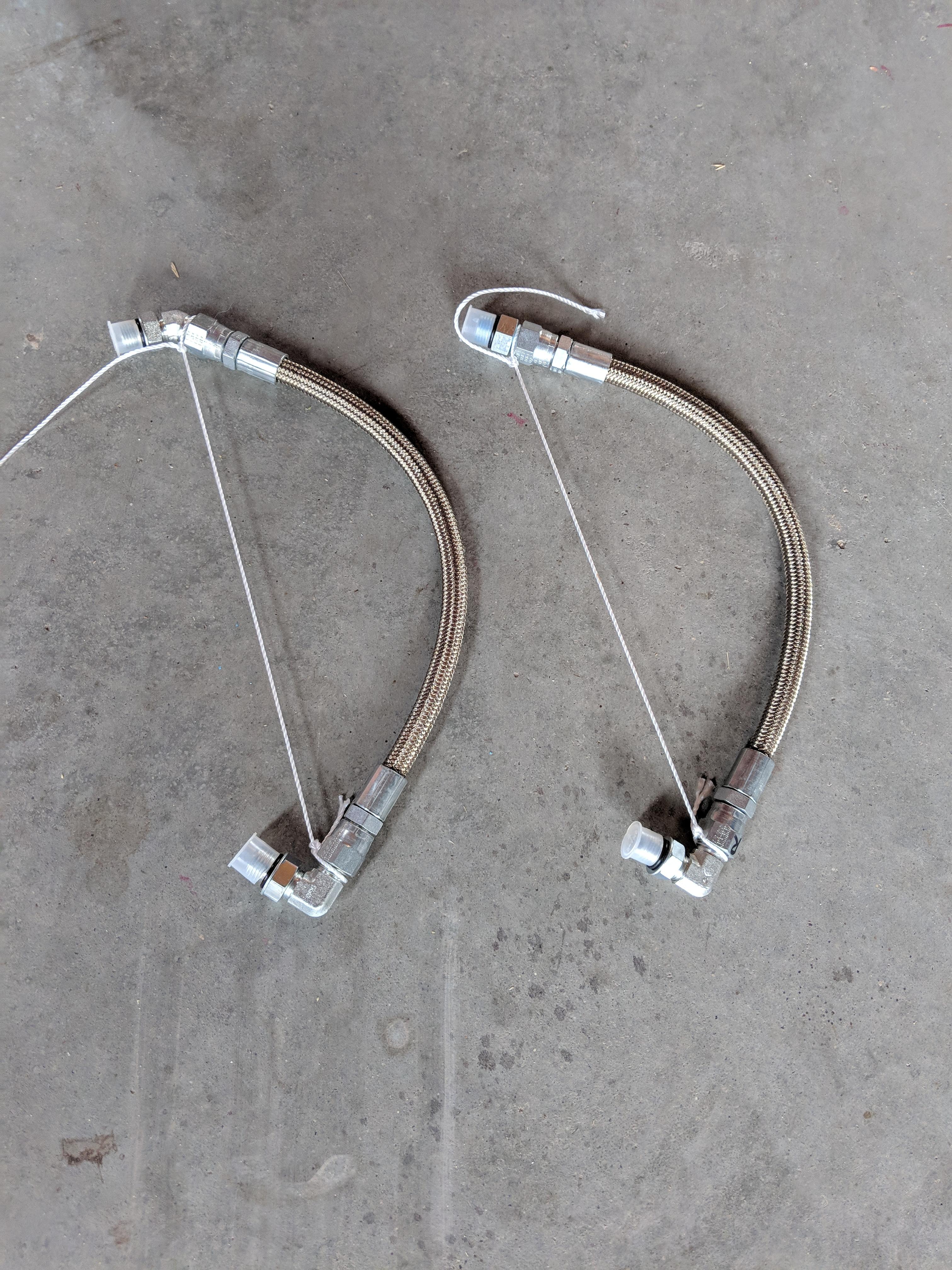

Originally Posted by BBslider001
Well, got them installed and here they are. Anyone knows this install isn't a big deal,but I figured some might want to see. I talked to Corey on the phone at length before I did this to ask about the Loctite use since I didn't have any on hand. Let me just say that removing the older fittings was butt-puckering. A tiny bit of thread came off the HPOP itself and those fitting were ON THERE. I know they were torqued to spec because I just resealed it this past Spring when installed it. I will not be using Loctite anymore. The O-Rings do their job. I have no leaks and install was smooth. I also took out the check valves when I did the pump fittings. CNC is doing some good stuff and has great customer service. I am glad to see them in the industry.
Shiny!!
Attachment 261921
In the thick of it, drivers line
Attachment 261920
Passenger side line
Attachment 261919
