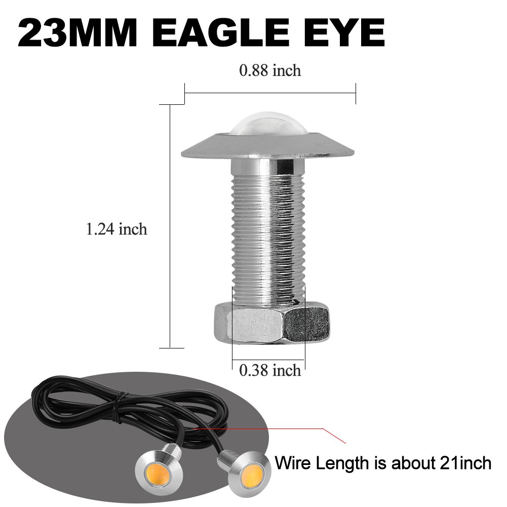

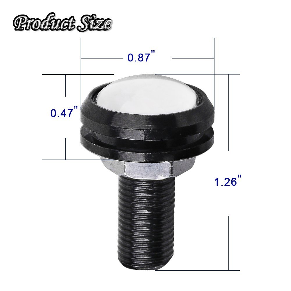

How much work do you want to do? With a DPDT relay, my cab top lights strobe. I drilled holes into my tail lamps and fog lamps to install cheap LED lamps and connected them to the same strobe circuit. Cheap LED in the lamp housing are not meant to project lighting, but rather illuminate for other people to see you. You can also drill into your headlights. You will need to drill into your dash for a toggle switch, and drill holes for wire runs.

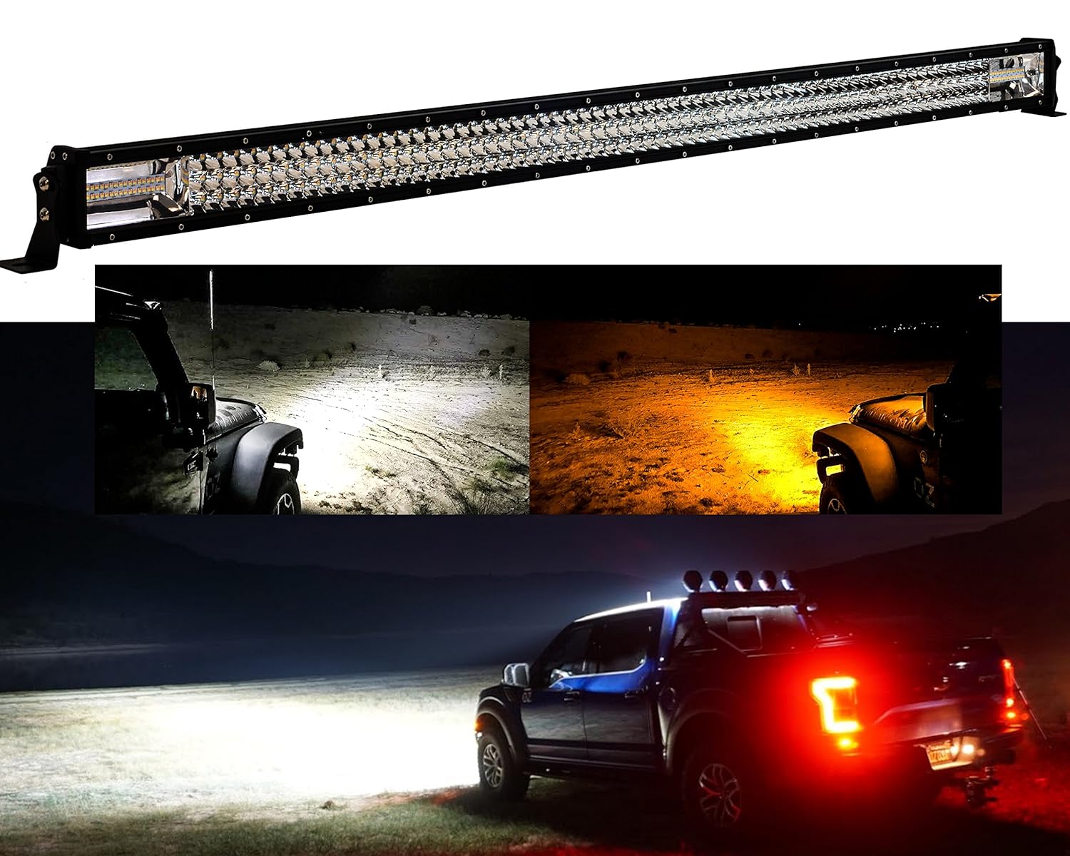

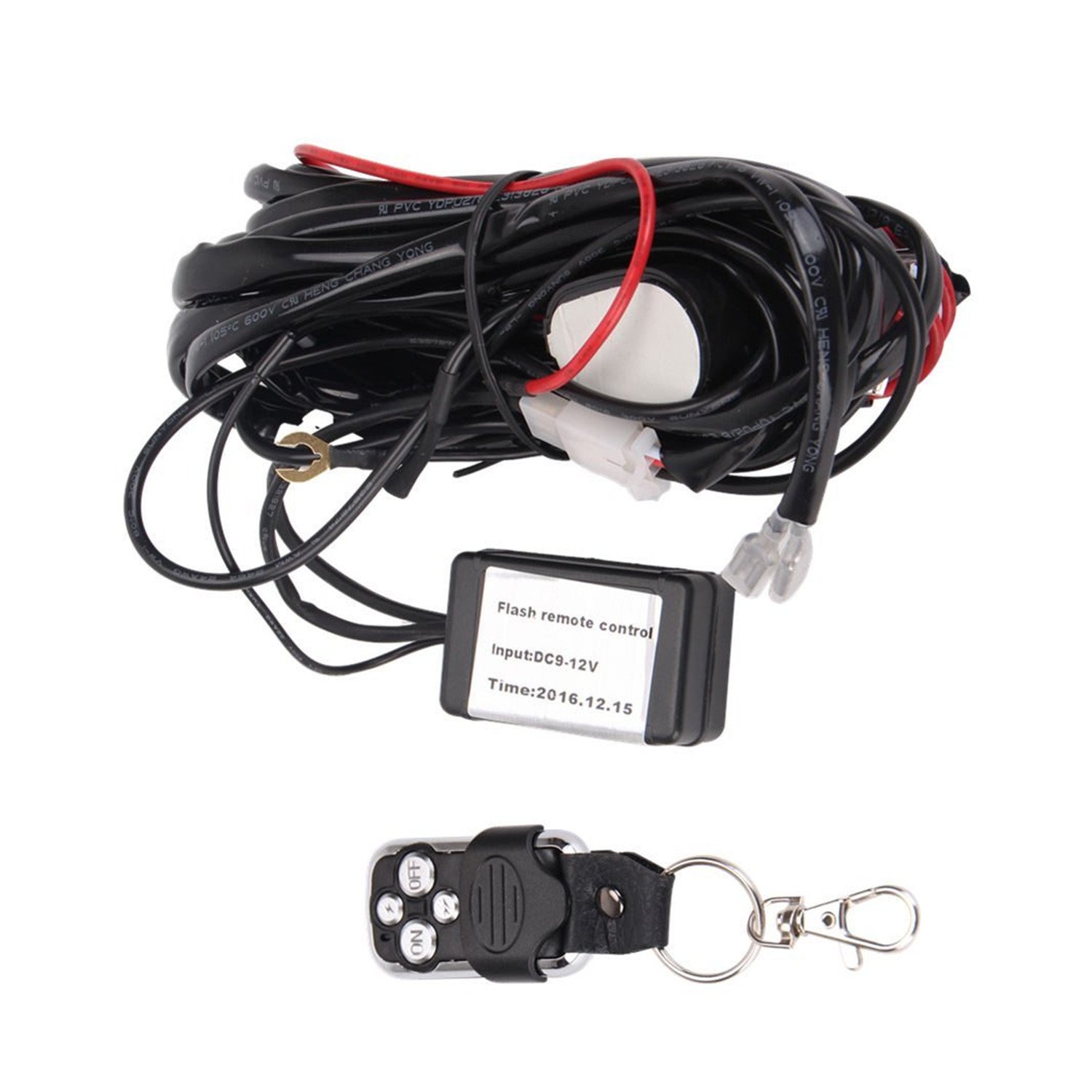

Interesting alternative is that there are light bar controllers which also strobe. You can add LED lamps to the circuit and strobe all of them in sequence. Very inexpensive parts from China.

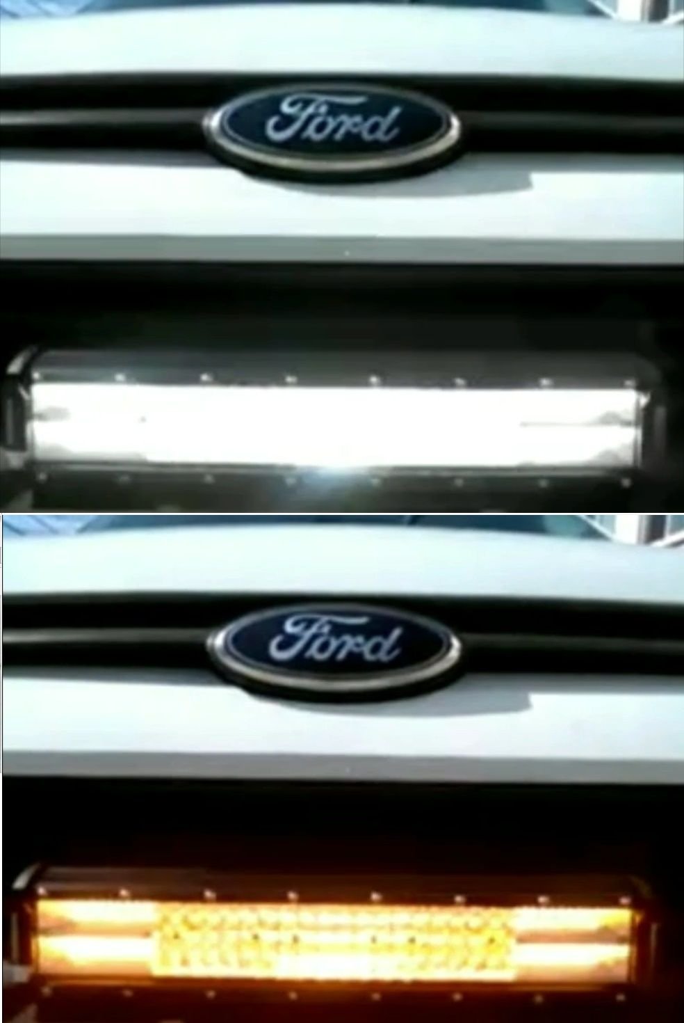

All extra lighting turns on solid for driving, and strobes for warning.
