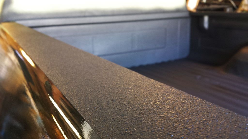

I went with Raptor Liner. So far so good

If that question was for me, yes I did. Before installing the hardware though I sanded down to bare metal, coated the entire bed with POR15, scuffed everything up real good, two coats of epoxy primer. I decided to install the carriage bolts before shooting the bed liner so they would sit snugly against the sheet metal.

I scuffed it up with a red 3M Scotch-brite pad. The POR15 was a bit glossy which us why I scuffed it up. I sprayed Epoxy primer over in an attempt to give the bedliner the best possible surface to adhere to. I am not a professional, but it seemed like a good idea at the time. So far so good after a couple years of use.
