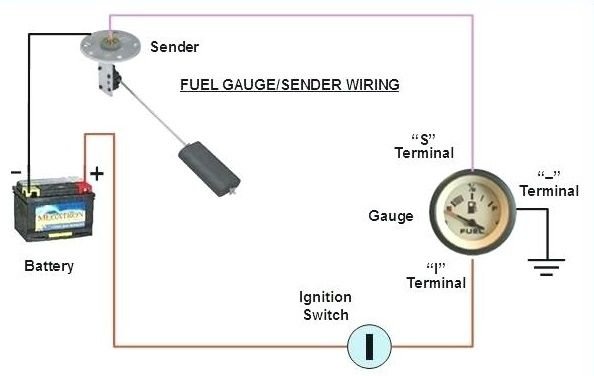

If gage is reading empty all the time it is most likely a short in wiring. Ohms for sending unit is 73 empty and 10 Full
here is a basic diagram
here is the back of my cluster I converted to 12V also and use a reducer to drop voltage for the fuel and temp gages
