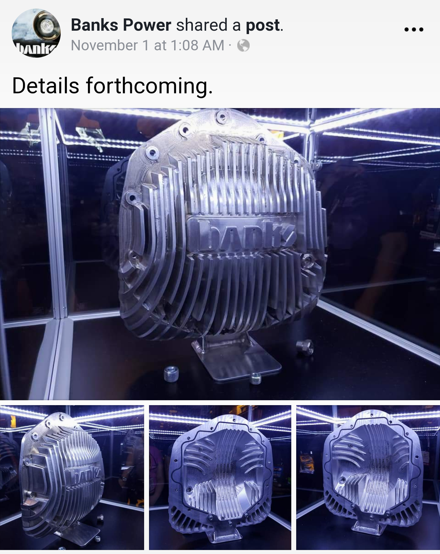

Old Nov 9, 2018 | 07:48 PM
  #37
mptjelgin's Avatar
mptjelgin
Joined: Jul 2003
Posts: 274
Likes: 20
So this whole "investigative series" has been a run-up to Banks unveiling their new aftermarket diff cover? Great...
Old Nov 9, 2018 | 07:55 PM
  #38
cangim's Avatar
cangim
Joined: Nov 2003
Posts: 3,595
From: Utah County, UT
agreed, what happened to the share data part....

Old Nov 9, 2018 | 08:39 PM
  #40
Overkill2's Avatar
Overkill2
Joined: Mar 2017
Posts: 31,882
Likes: 9,176
From: Western NY
I can't say I saw it coming, but I can't say I'm surprised either. I'm thinking that once they started to test the aftermarket flat covers and saw what the (assumed) deficiencies were, Gale was probably like, "We could do this better." We shall see. He is putting more thought and testing into these than all the aftermarket diff manufacturers put together. Hopefully not only will it have bling, but it will function like the others only claim and don't.

Old Nov 10, 2018 | 10:56 AM

Old Nov 10, 2018 | 12:02 PM
  #45
mptjelgin's Avatar
mptjelgin
Joined: Jul 2003
Posts: 274
Likes: 20
At this point I would take any data in the flat covers with a grain of salt. What started out looking like a (somewhat) independent third-party look at aftermarket covers has obviously turned into a marketing exercise. Any data presented now will be skewed by that, in my mind.
