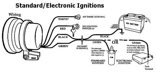

Installing a tach is easy. Buy one, the hook it up. You need four connections: ground, 12v key on power, 12v from the dash light circuit and negative coil.
Takes 15 minutes to do.

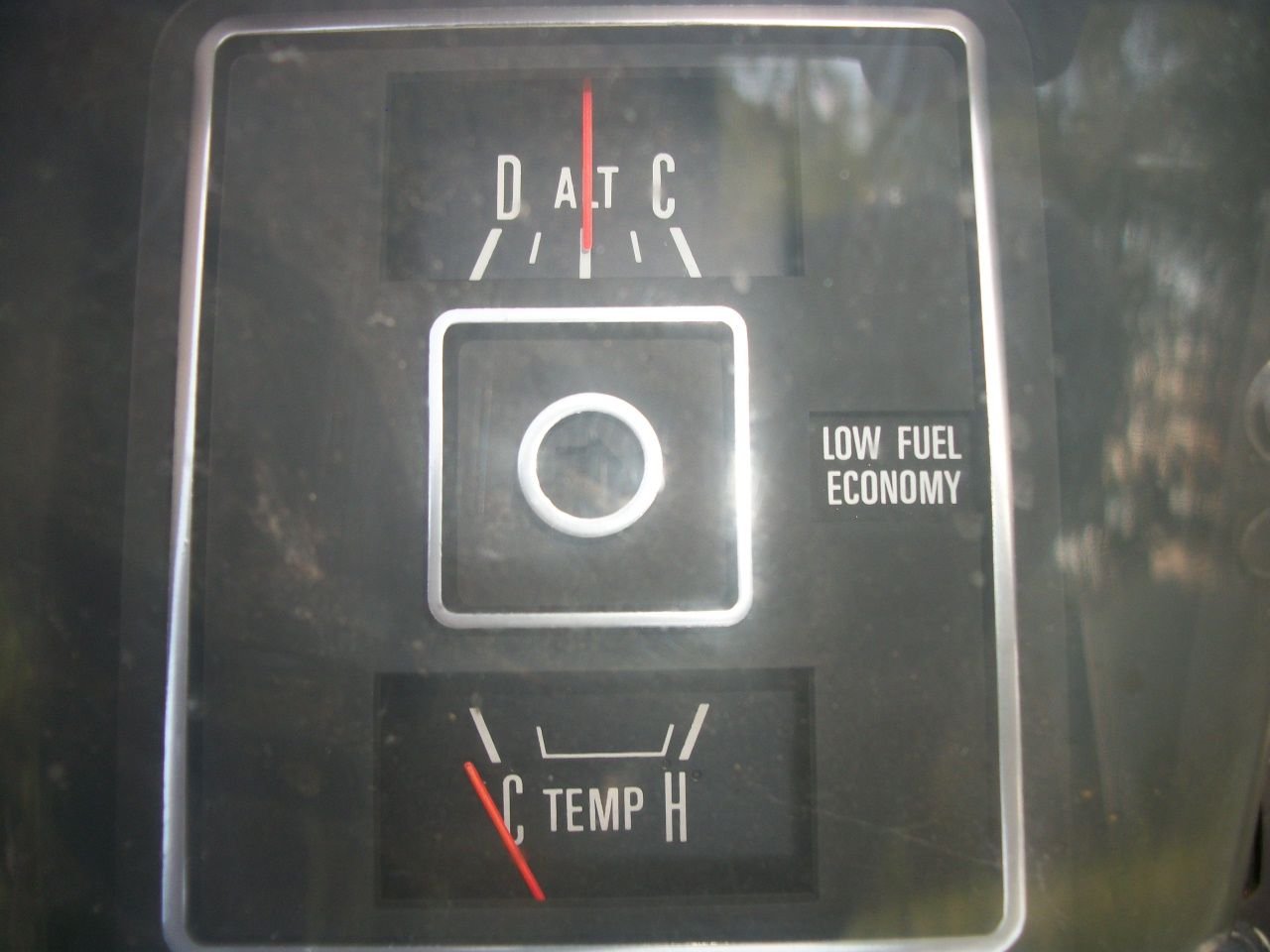

I'd guess to keep things cheaper no tach was designed in by Ford in 73-79 F100, F150, F250, F350 trucks? Then in the 80's some smart guy figured out that staying in a certain RPM range gave you better MPH. Actually some of our trucks came with a Low Fuel Economy light...can not remember if that light was on standard trans trucks only?
The "when to shift, by ear" technique is something I thought that most fathers taught their sons at a young age. Like during their 1st driving lesson, say around 12 to 14. A good ol farm truck was always a 3 (on the tree) or 4spd. And you had to know how to drive it to help with chores. Also back in the day you did not need a light to tell you, you had the park brake on and or left your headlights on. Or a stupid chime to remind you the key is in the ignition. And the biggie, you could start it with the clutch OUT...

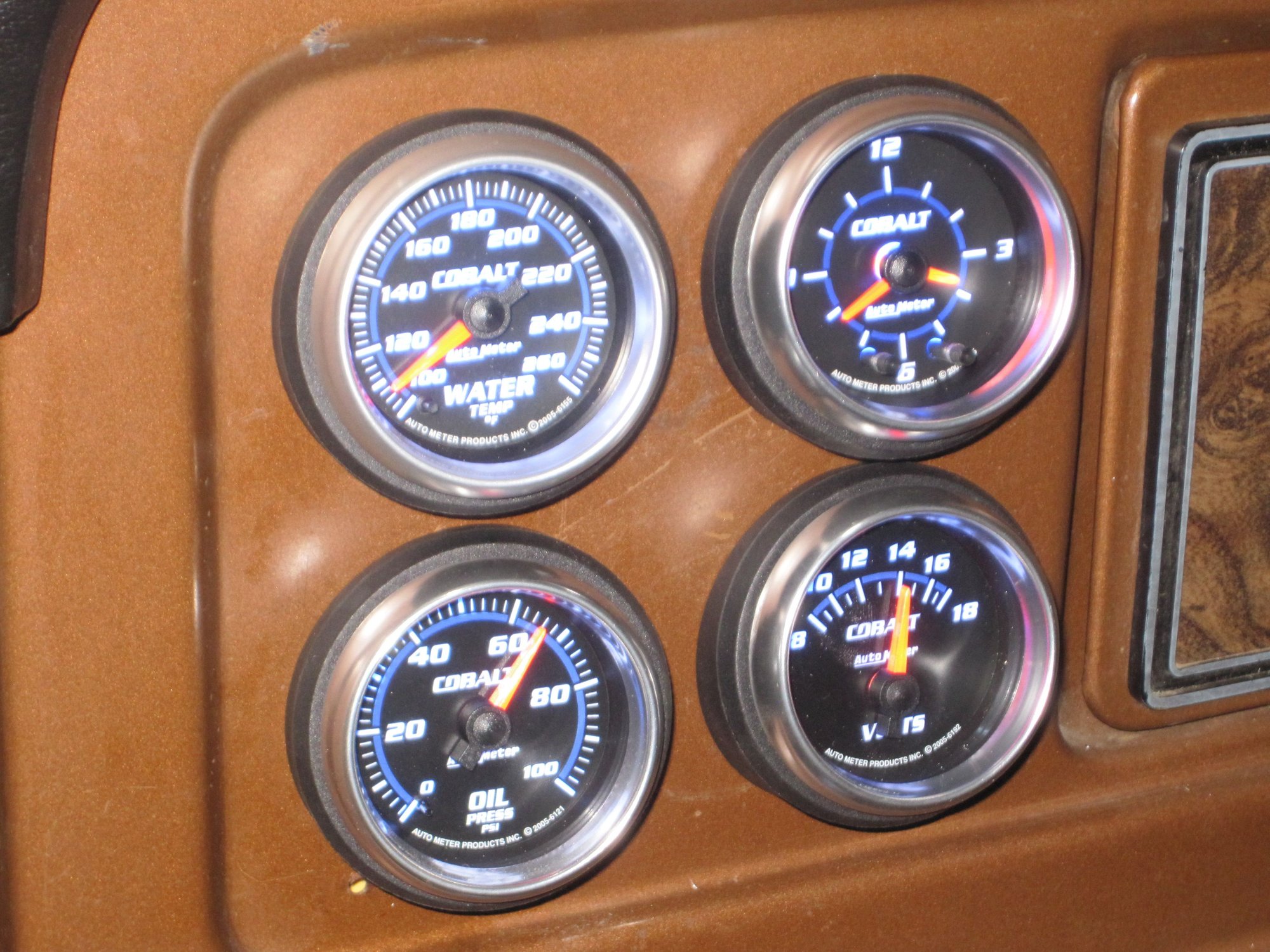

Here's a placement option if you don't have AC.
Dash with Tach
Nope, automatics too. 1975 only IIRC. It was a simple vacuum switch. When disconnected from a vacuum source, it stays on all the time (ask me how I know). The orange glare in my face at night is a little obnoxious, but it makes me giggle a little every time I drive my truck.

I got a 75 f250 2wd with a c6 and it has a low fuel economy light. What do they consider "low economy" lol.
Old Sep 15, 2018 | 06:11 PM
fordguy2100's Avatar
fordguy2100
Joined: Jun 2015
Posts: 2,240
Likes: 23
When your fuel line is cut dumping gas on the ground... about the only thing lower than the regularly running engine
Dash with Tach
This is genius. I know you posted this in 2018 but would love to know if the tach you put in your dash had a locking nut on the back? If so what brand? If not how did you secure it to the dash. Also love the steering wheel
Old Nov 14, 2020 | 10:39 PM
march's Avatar
march
Joined: May 2006
Posts: 1,140
Likes: 13
From: Port Orchard Wa
Thanks,
It's an Autometer gauge. I just used a hole saw to cut the dash panel. The gauge is attached in the same way it would attach to any gauge panel and the parts come with the gauge. (A U shaped bracket that fits over studs in the back of the gauge. You tighten nuts on the studs to pull the gauge up snug to the panel face).
The steering wheel was a lucky find - original sport wheel option.
I've installed similar gauges in the dash... I bought a separate tapered bezel kit to put under these gauges so they tilt towards the driver.
Thanks,
NICE! Thank you sir. I will be doing this very soon. It looks way better than the ones people put on the column. I love this site and the people on it.
