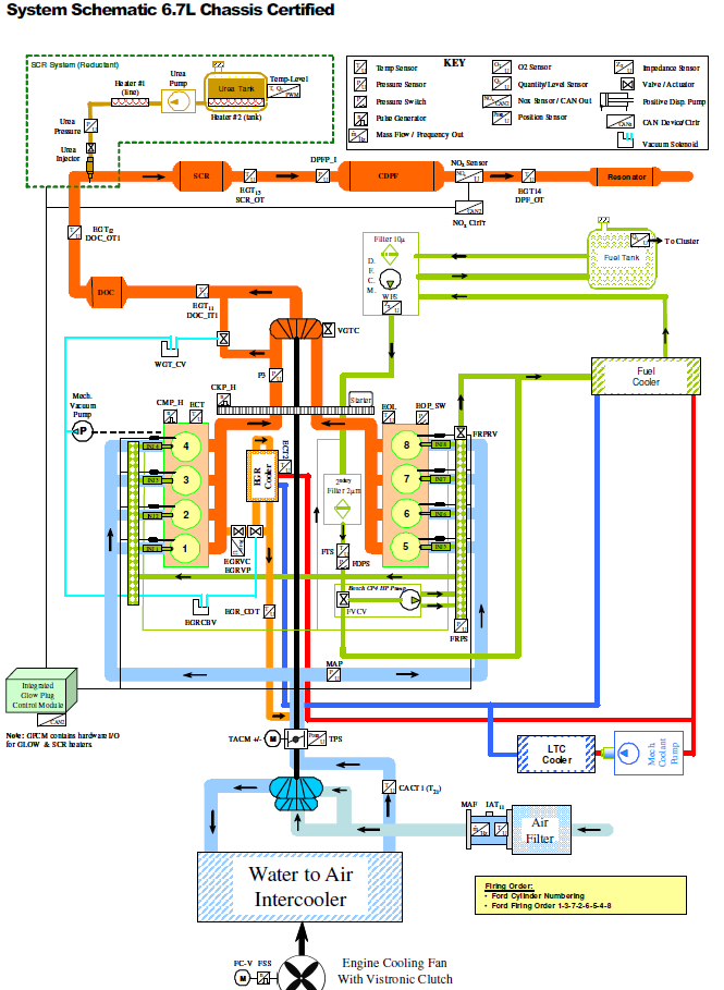

DEF (SCR) and DPF are two technologies.
First picture is the pickup exhaust (DPF is last).
The second picture is more detailed but for the cab and chassis, which is different than our pickup models (DPF is first instead of last).
Edit: actualy the DPF is in the correct order...
Last edited by kper05; Sep 10, 2018 at 10:36 PM. Reason: schematic does show DPF last
