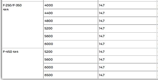

This past weekend I spent several minutes at my local dealer measuring the distance from the 4wd hub center to the bottom of the fender wheel well. I used this distance to avoid tire size variables. I compared many trucks....Snow Plow packages to Camper Pkgs to no suspension package trucks. While there might have been 1/4"-1/2" variance between them, the only conclusion I came to was the diesels were about 1" less. That wasn't a big surprise since we know its heavier than the gasser. All of the springs are the same height (14.7"). Now once you start loading the truck, the (heavier) springs would come into play.
