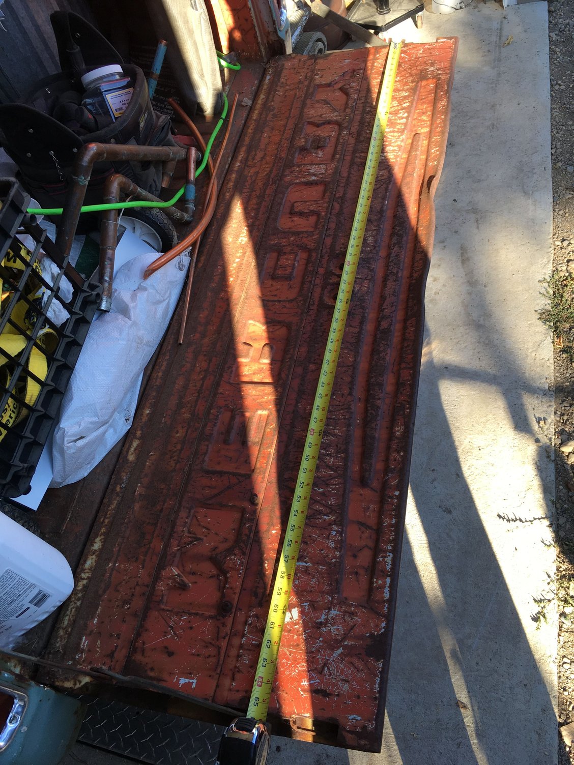

Odysseus1968's Avatar
Odysseus1968
6th Gear
Joined: Sep 2018
Posts: 6
Measuring points reference.
I'm not sure my info adds much more to the thread but, for reference, my old 1966 F250 tailgate comes in right at 65 9/16" FWIW... (The broader picture is to show where I measured from.)
Brett

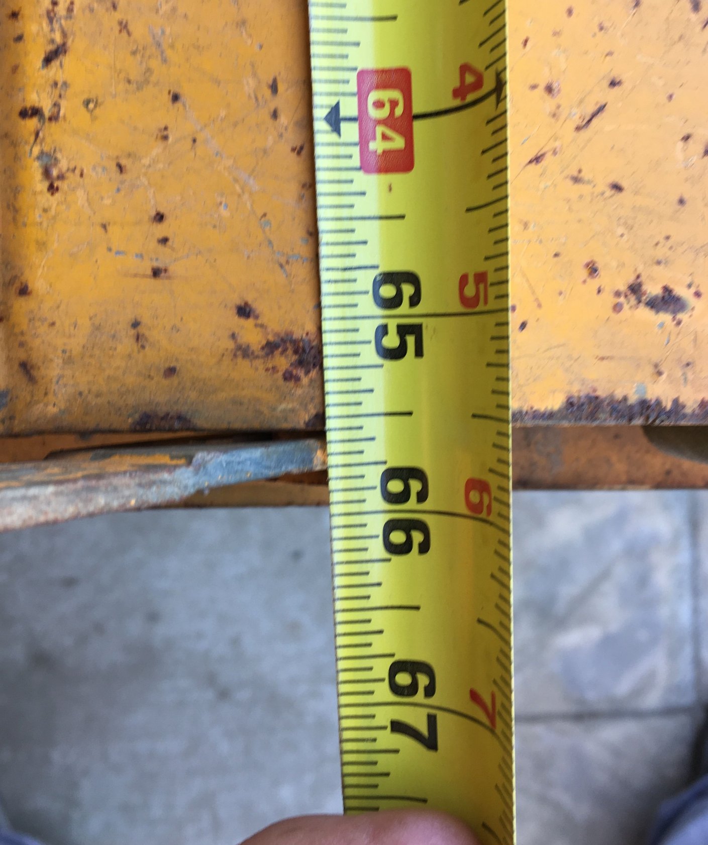

RangerMercMan's Avatar
RangerMercMan
Joined: Aug 2016
Posts: 1,480
From: Great White North
1st picture
I thought I would speak up for Mercury and add my two pics ha ha. I measured the first one at 65 1/2" and the second pic I started the tape measure at the 1" line to eliminate the built in slop of the clip of the tape measure. It measured 66 1/2" - 1" = 65 1/2". Now to be picky about it on the first round I could have called it 65 7/16"
