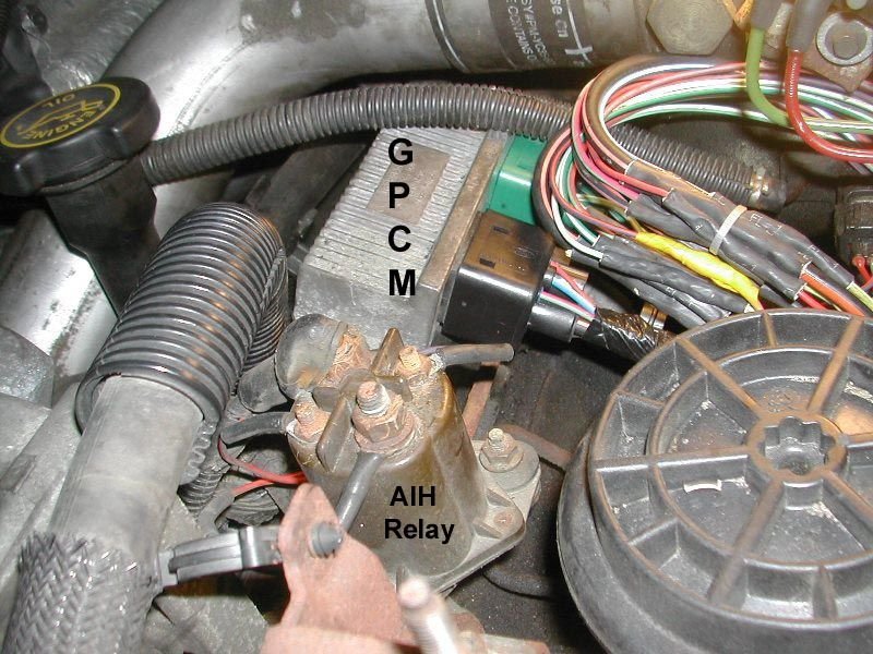

the issue as far as I have been able to figure out is my CA Excursion has a Glow Plug Control Module where federal models just use a relay. I can not get a straight answer from anybody who knows about these magic boxes if or how to use a diffrent box.
so the question is, Does your Ex have a GPRM or just a relay ?
Fwiw, this is the GPCM located just behind the fuel bowl on the passanger side valve cover.

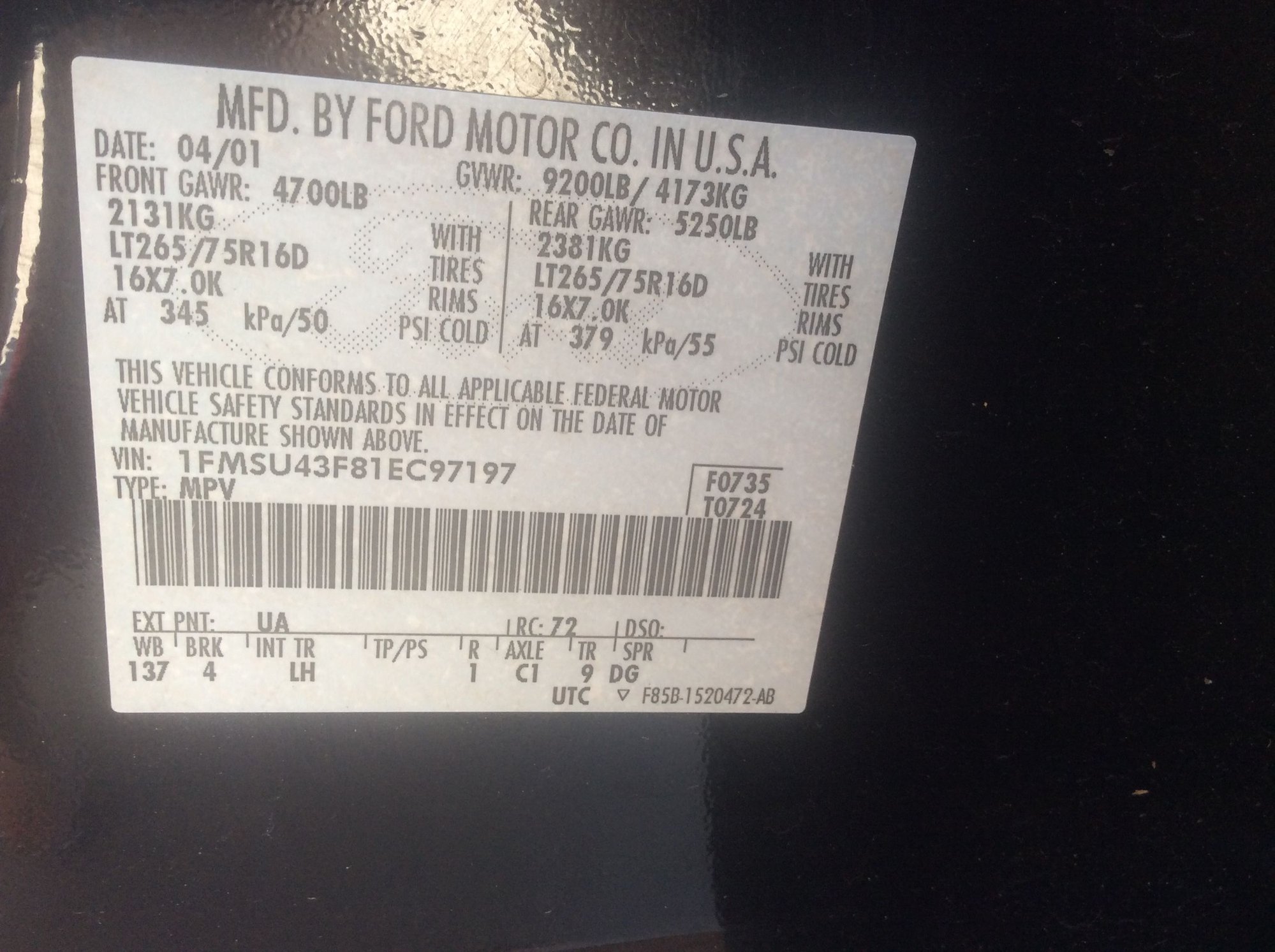

Here you go...
Originally Posted by pirate4x4_camo
Interesting ..... in searching for this damn thing I noticed the 2000 and 2001 are lumped together with 2003 having its own part number.
so my understanding is the DPC # is the hardware code, what could be or is diffrent about a 2003 7.3 Ex That it has a diffrent PCM ?
Do you happen to have the part mumber or a pucture of the sticker ?
