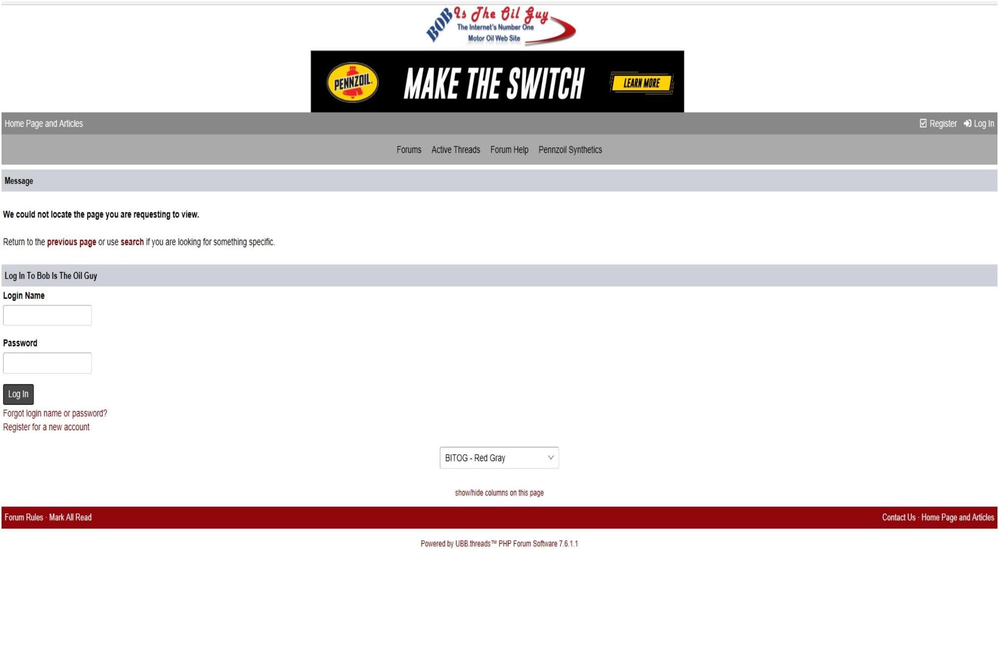

This is what happened when I tried to access the page, do you have another link or do I need to sign up? Thanks

No, thats strange: https://www.bobistheoilguy.com/forum...Number=1820207
