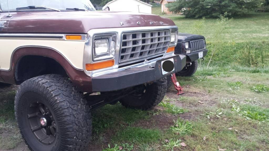

Here's the bumper:

I have the same exact looking bumper as yours but mine has a Warn sticker. It looks factory to me. While it's not a 100% guarantee, I would guess your bumper is actually made by Warn.

Looks just like my Warn bumper. I've seen 2 different types of these bumpers. The ones like pictured here with rounded outer edges, & the other type with the outer edges being more angled & square.
I haven't got a winch to fill the void but I added a couple of old ammo cans for storage.
