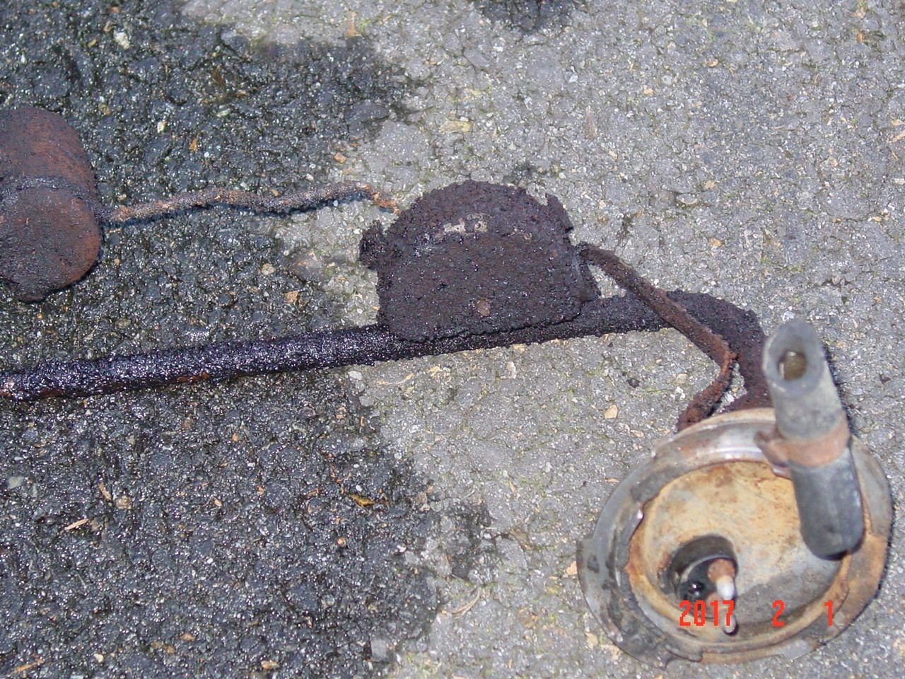

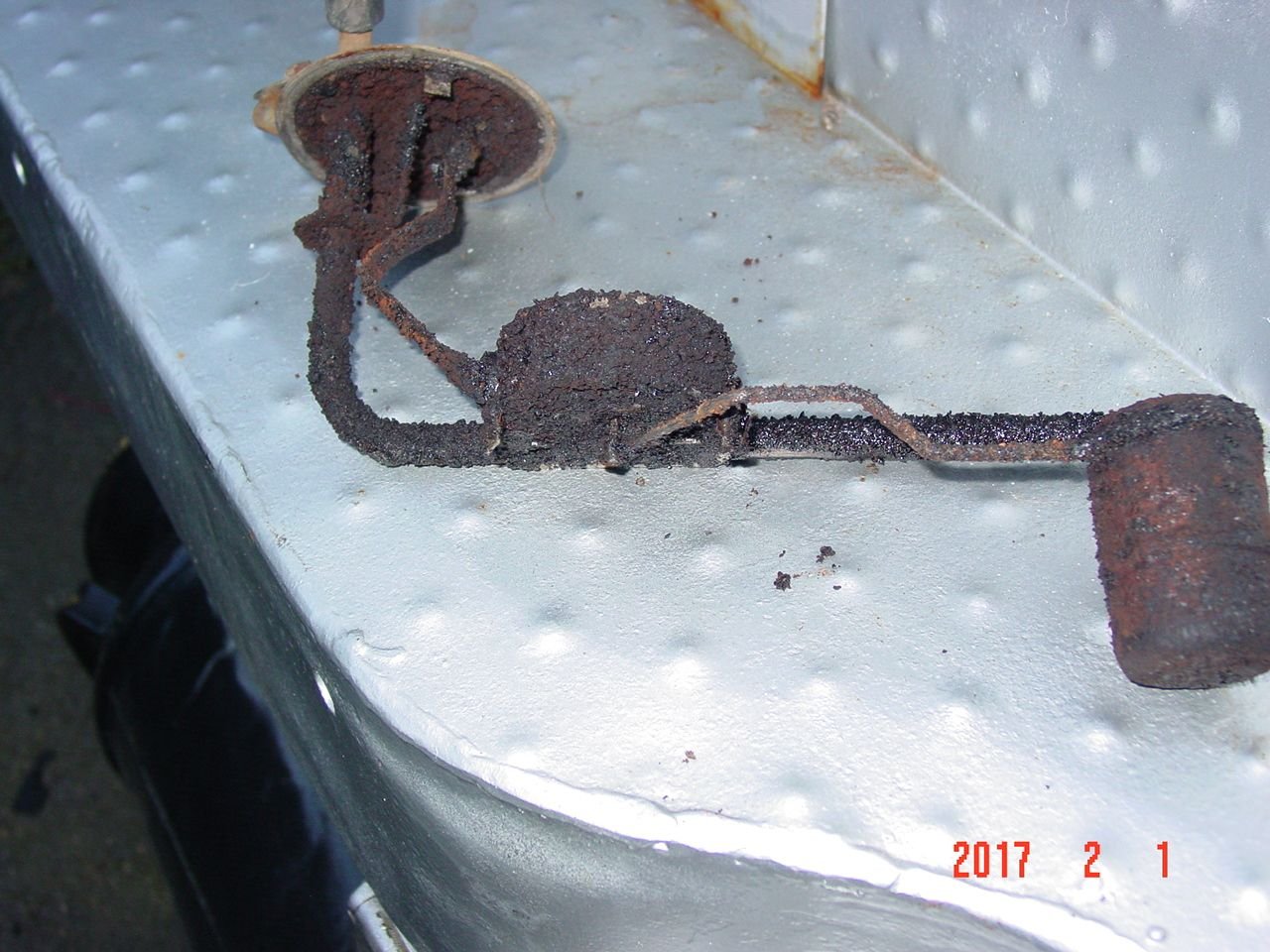

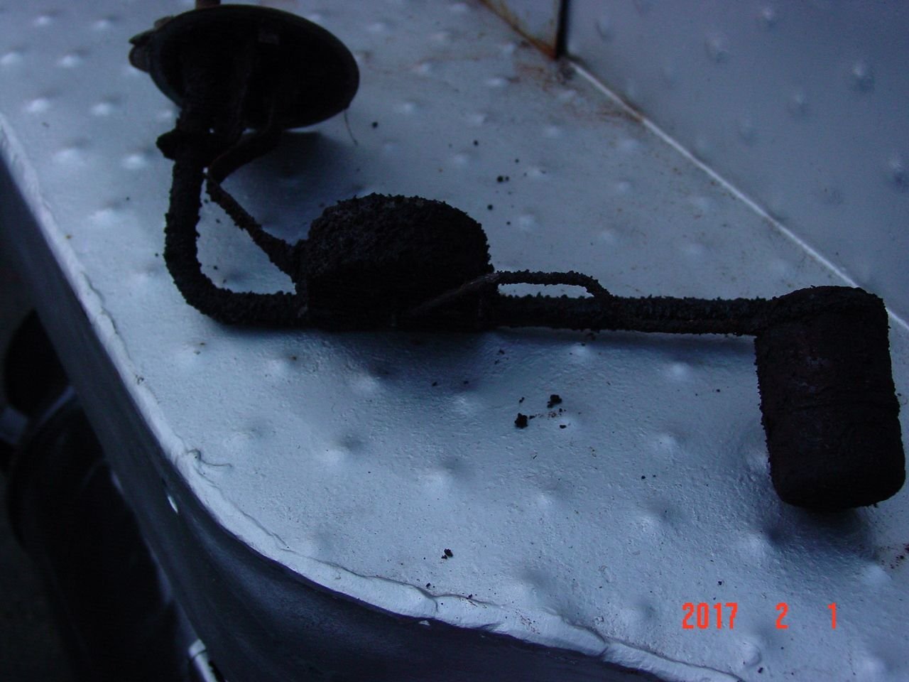

My truck sat in a field for 5 years, so even tho the PO (previous owner) had cleaned the in-cab tank, the aux tank was full of old junk that was tar like on the insides. The sending unit and the gas pick-up tube were sealed solid.
It was a good thing the new tank came with a new sending unit.
Same pic with flash.
I was able to clean the brass float, but I wasted my time.
