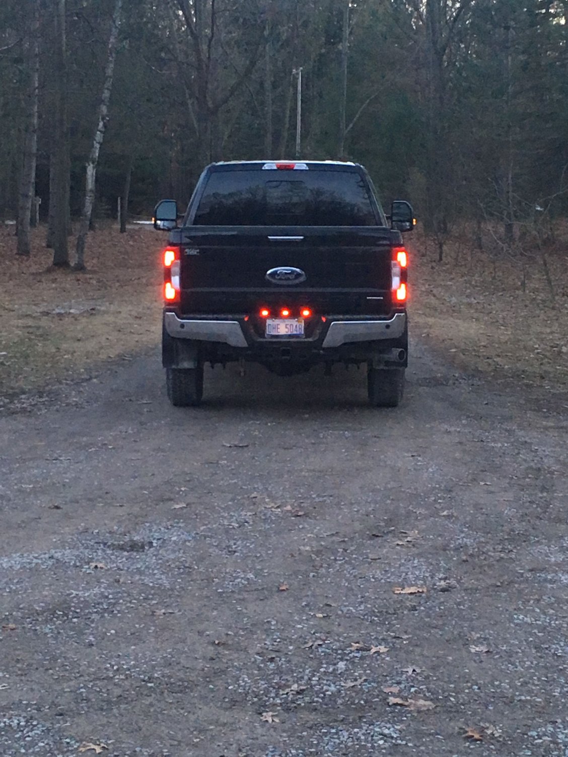

I added the three light bar that are on the dual wheel trucks. The light is a factory ford item and I used a t-harness from MagnumTruckRacks that plugs into the harness on the passenger side by the spare tire. This can be used for different things as you can add running lights, turn signals, and backup lights. Simple plug and play with no splicing into truck wiring harness. It was $95 when I got mine. No issues for me at all. My truck is a 17 XLT.

I also used the magnum harness and it worked perfectly, no splicing into the factory wiring giving it a nice clean appearance underneath.
