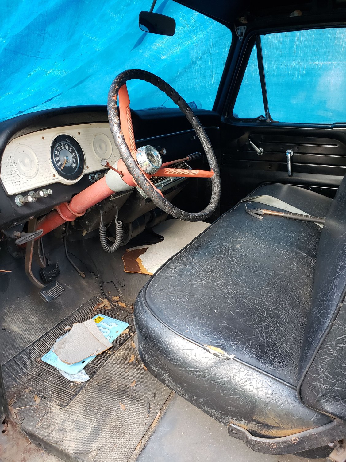

I have most of my door plate items found, but cannot quite figure out the interior trim. The only thing I can think of would be on the body code. Mine is 581, and I want to assume that the trim is supposed to be the 5? If so, something isn't right as my interior is black and white, except for a red column and wheel. Nothing has been changed on this truck interior wise, as my grandfather bought it new and told me he only changed the size tires he used. Would appreciate help on figuring this out. Thanks

Seat upholstery is not original. From what I can see the dash pad is not original, either. Not very many of these trucks left with their original upholstery still intact.

Alrighty. I guess he forgot about having it done. That makes sense though. I appreciate the help! Thanks man!

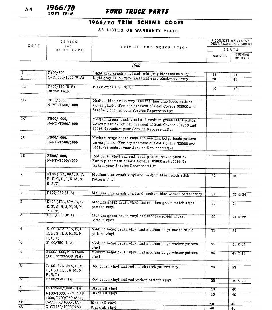

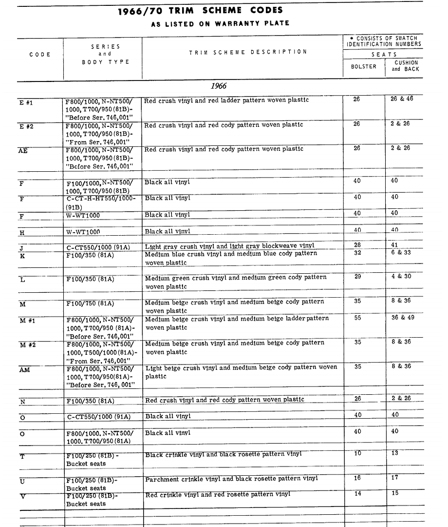

For 1966 there wouldn't be a 581B. The reference I use is the Master Parts Catalog - Soft Trim Parts section. The 81A or 81B is shown in the second column.
Each year can be different from other years so it's best to look it up. Some have assumed a leading number instead of a letter means Standard Cab. Not necessarily. These are two of the three 1966 specific pages.
581 in 1966 is always 581A Standard Cab.
