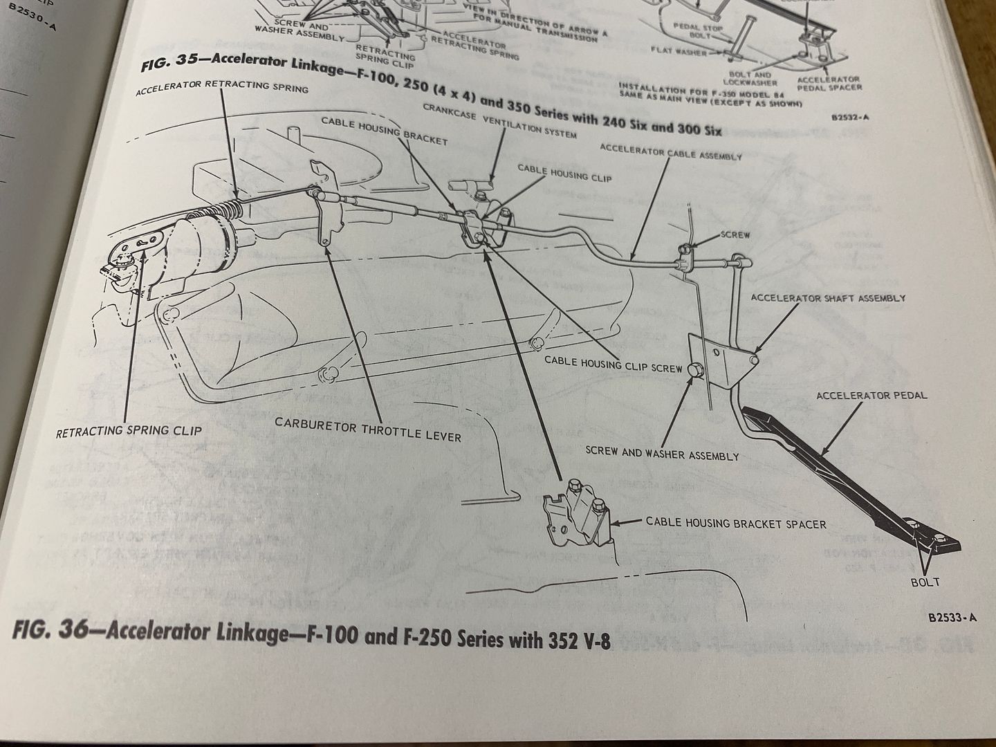

That's ludicrous!! Seriously though, have they all broken in the same spot? Different places? There is a way of adjusting them so even at full throttle they are not getting stretched. From the 1965 Shop Manual.
Of course, if you are not using the stock 2-barrel Autolite 2100 then this may or may not work as well.

Here's Figure 36 that is referenced in the shop manual text I posted previously.

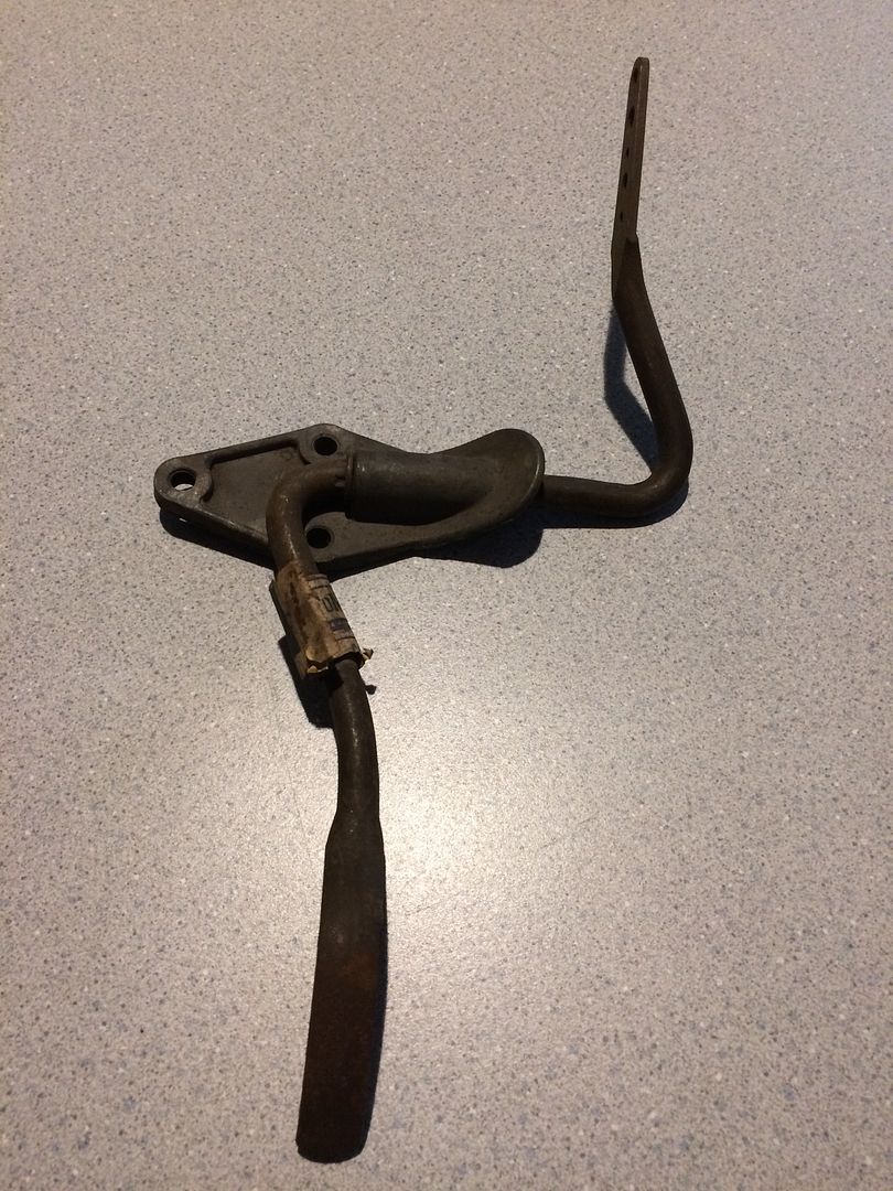

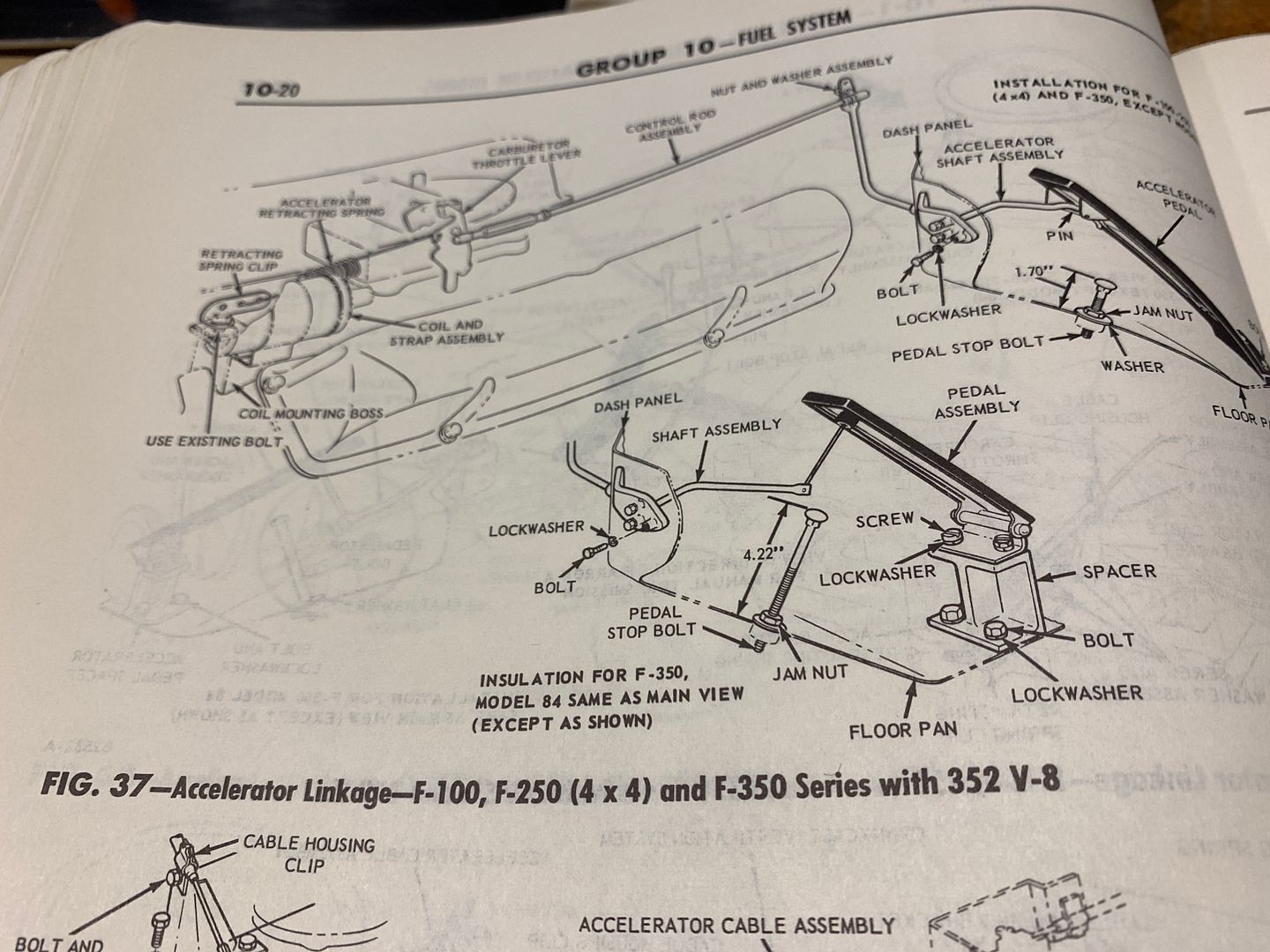

Also, here's Figure 37 which represents the 1965 F100/250 4x4, 1965/66 F350 and 1966 F250 4x4 with 352. I wish they had done the same with the 1965/66 F100/250 2WD trucks that they continued to do with the 4x4 and F350 in that it used a bracket mounted to the firewall with 3 bolts and the accelerator shaft assembly pivoted inside of the fixed bracket. The arm on the engine side stood up vertically a few inches which gave the clearance to get above the valve covers some and then they had a threaded rod from that pivoting arm to the carb.
This could possibly be adapted to the 1965/66 F100/250 2WD but the thing that's different is the shape of the firewall where this bracket has a bend in it to conform better to the cabs with the high step inside the door.
