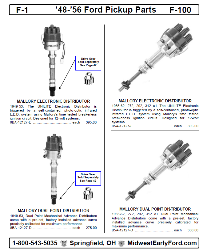

From the Midwest Early Ford catalog

Those are not for the straight 6.
Are you missing your stock distributor, or does it just need rebuilding?
