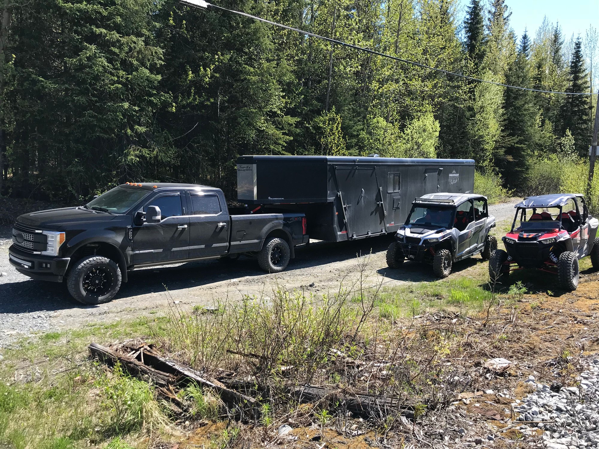

I have no problem what so ever with clearance pulling my gooseneck all over Canada and Alaska. Stock Trailswest gooseneck and my truck is lifted front and rear 2 inches. I’d hook up to one before purchase obviously and see where she rides
