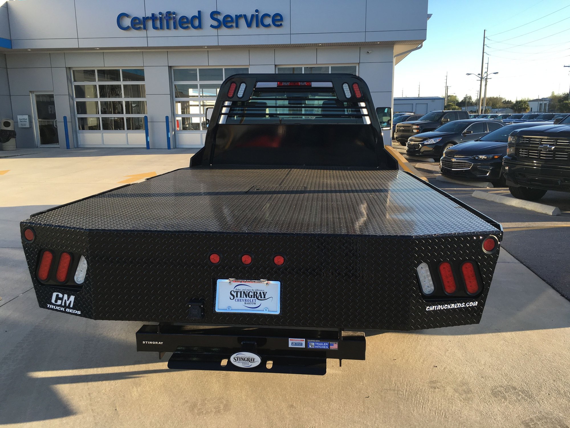

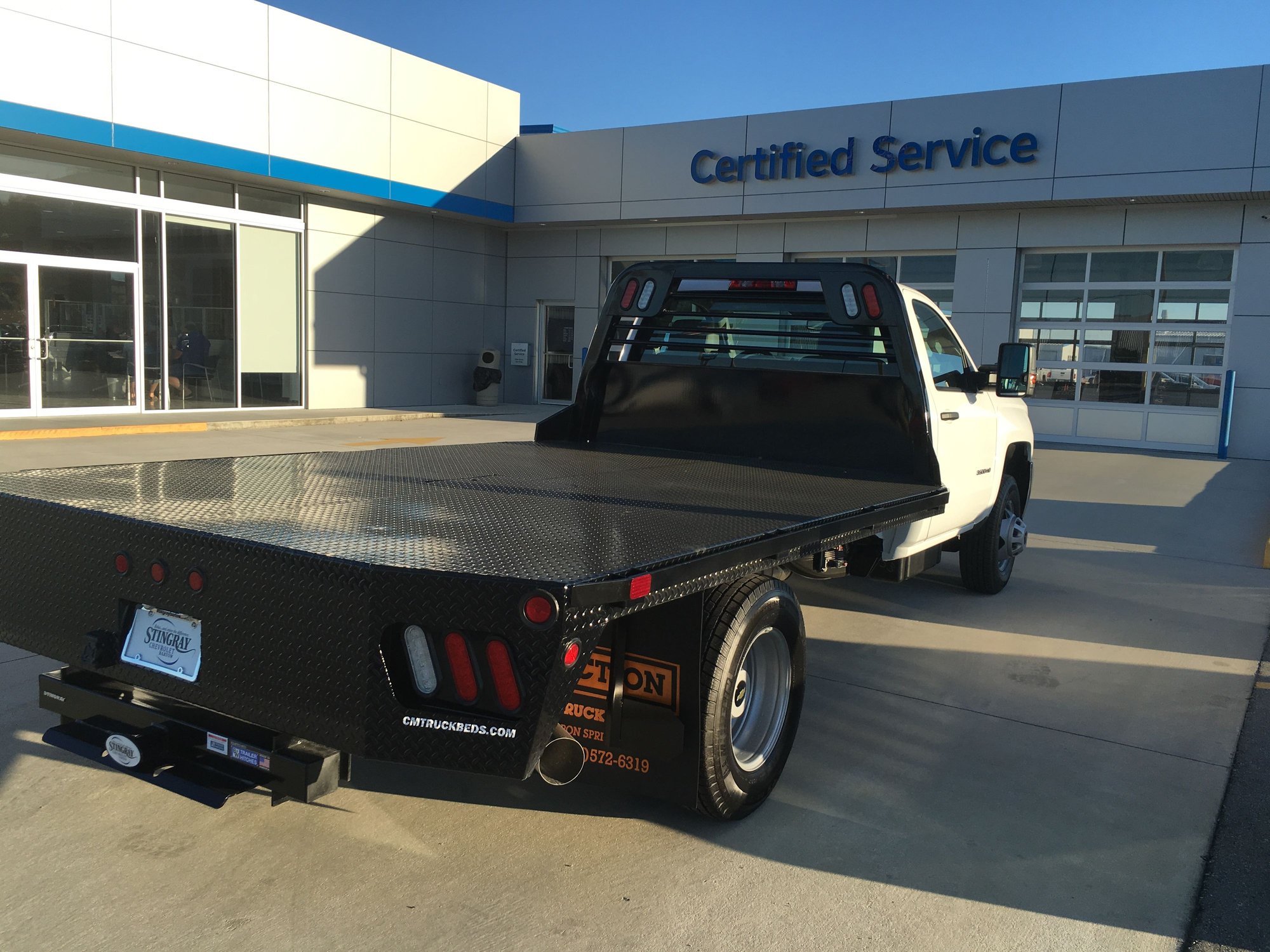

Hmmmm, well Mister, CM makes some good truck beds. I reckon a feller would do aight with one of them, as Carl would say. One of my favorite movies, by the way. We have had two flatbeds with the CM beds. Our current one is on a '15 3500 HD regular cab diesel. It is about 11-12' long with the dog-eared rear end for gooseneck and 5th wheel clearance. It has the headache rack with the round horizontal members vs the expanded metal that was in the first one. This is a real nice improvement because doesn't create near the wind noise as the expanded metal. It has full LED lighting as well as rub rails with stake pockets. Ours is steel and the finish is holding real well. This one came on the truck but if I were in the market for a truck bed I would strongly consider this brand. They have a large dealer network so you shouldn't have an issue finding one, especially here in Florida. The one you have picked out looks very nice. Good luck in your search.

Just found these
