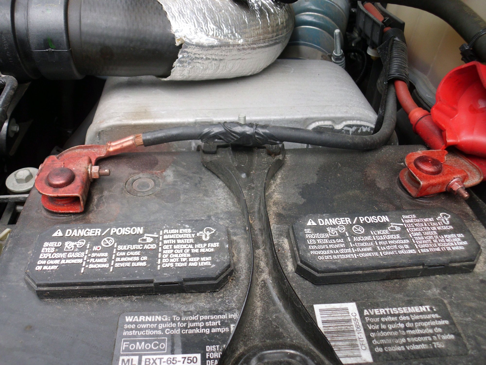

+1 for the Anti Corrosion battery Terminal Spray. Here is A Shot of my Stock 2016 Batteries. You can see some moisture near the Vents but no Corrosion.
