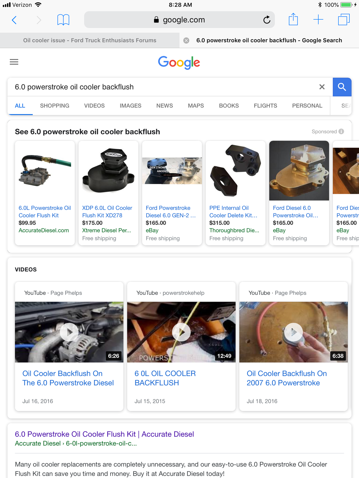

Backflushing is covered on every 6.0 site, with equipment both DIY and purchased, you just need to search. It can effectively be done either way, depending how quickly it’s done.
This site site has gone through a number of threads, including an out of box method from Dick Nitro.
