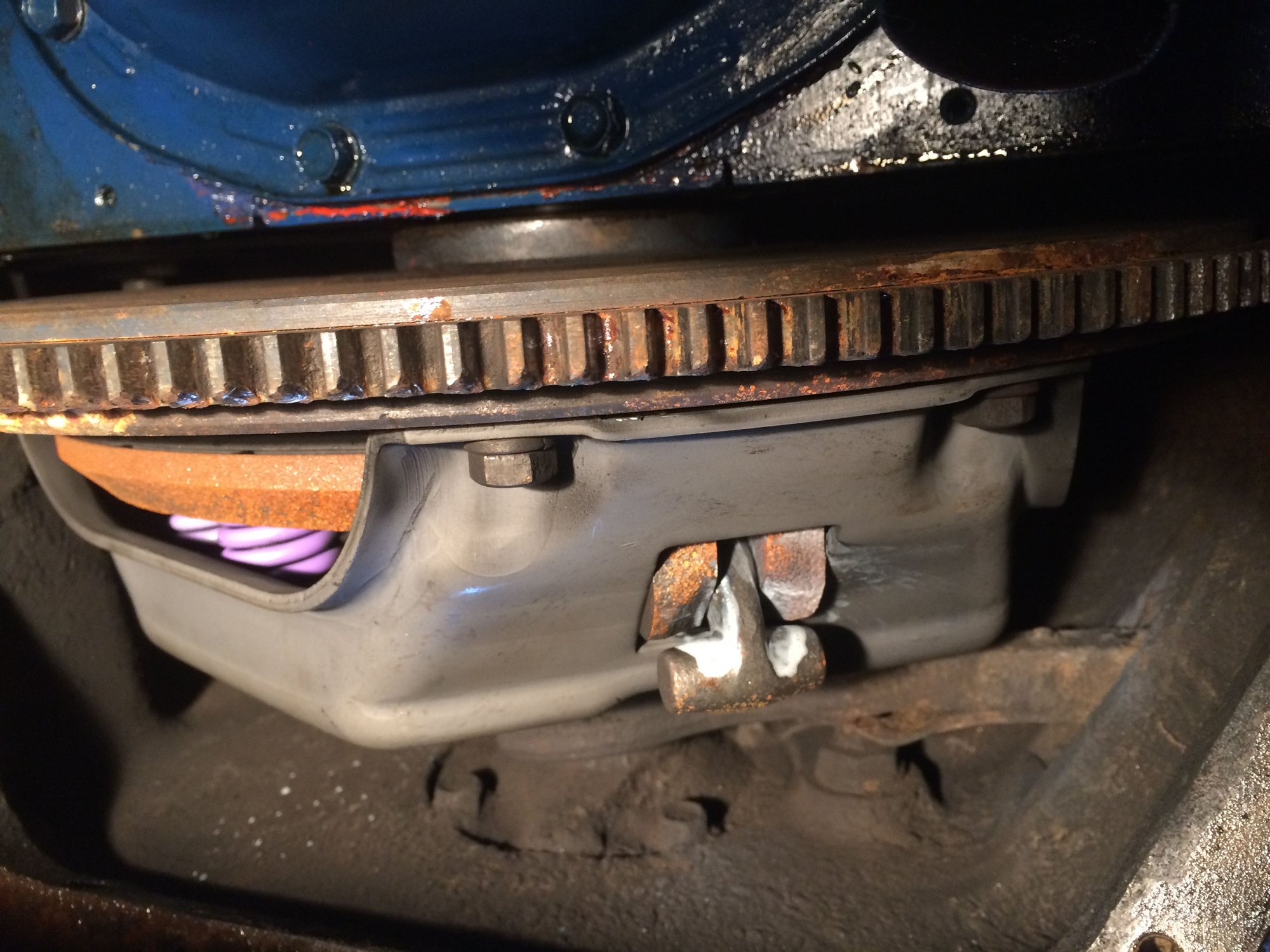

Does
Does anything look out of place here?

I personally don't see anything that looks out of place from this angle. I can see the flywheel, the clutch disc and the pressure plate behind it. But, you wouldn't be able to tell if the disc is contaminated from here most likely. Any oil or grease on the surfaces can quickly get burned into the clutch disc and cause shiny spots that allow the clutch to at least partially slip. If that's not what you think could be happening then regroup and reassess the situation. It's very hard to troubleshoot some of these issues, especially from an armchair sitting hundreds or thousands of miles away.
Chad

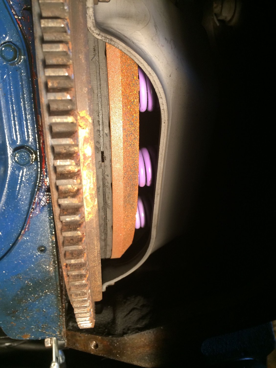

Pic 1 you can see the clutch disc between the flywheel and pressure plate, as is normal. In pic 2 the clutch does not appear to be there, and is abnormal. From the angle of the pic 2 it kind of looks like the pressure plate hat is not tightened down completely and in contact with the flywheel.

Not disagreeing, but I'm guessing that is the angle of that second picture. It's taken looking more "up the front" (non-surfaced) side of the flywheel so the view of the clutch disc itself it mostly obscured compared to the first picture. Just an odd angle for what we are looking for, I *think*.
Chad

Good call 455HO. After taking another look I think you are correct. I can see the little wear indicator marks of the disc. Sorry about that.
