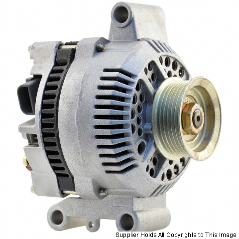

A 1994 F150 5.0L & 5.8L should have the 3G alternator and mounting in the photos was right.
A 1994 7.5L takes a 3G with different mounting.

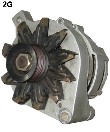

The 1994 4.9L takes the old 2G alternator.

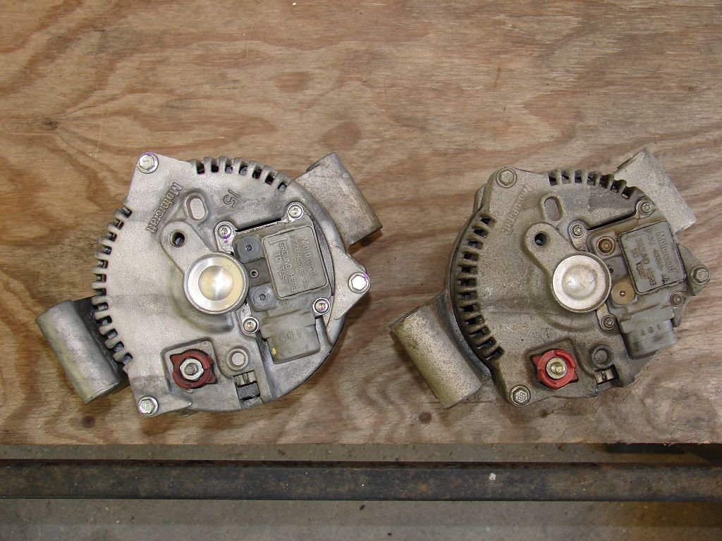

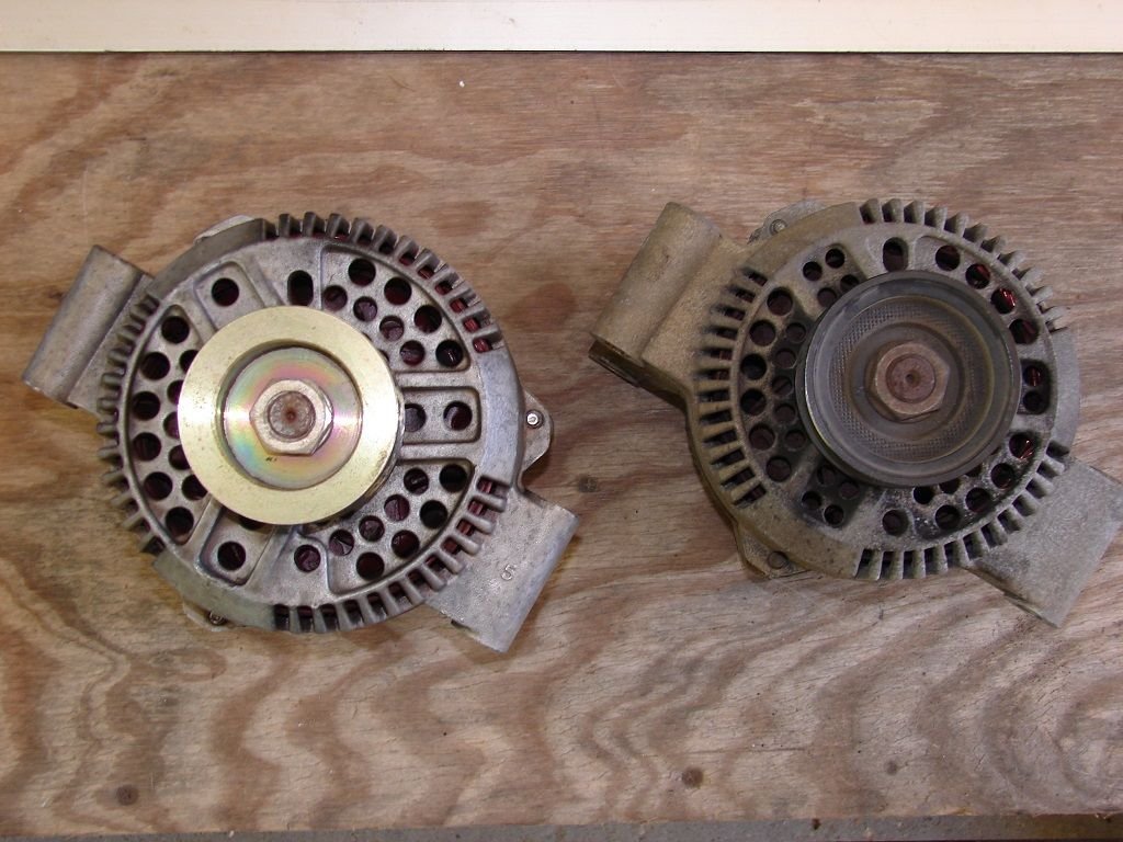

Below is the 95 amp that came on my 94 5.8 on the right & a 130 amp removed from a 95 E-250 with 5.8
Notice the hole patterns on the face.
Note the back side is identical so your harness will plug right in.

Adding to all that has been said, you'll only need to replace the harness if your original alternator was a 2G (external fan). If you already have a 3G OEM then you just need to find a replacement with the proper mounts (as pictured) and replace. If you think you'll need the extra amperage go for the big case (check Scndsin pictures out, the big case 130A has 2 holes x 3 in the frontal cover vs 4 holes x 3 in the small case 95A one).
