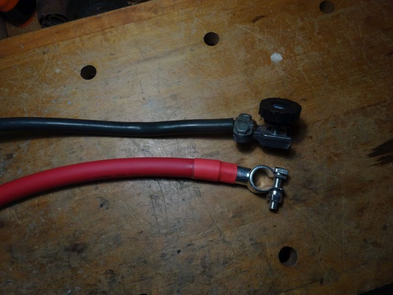

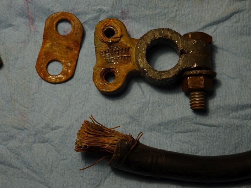

I was having trouble with consistent starting of my 1952 F2 with 239 flathead. Also, the battery never seemed to recharge completely even after some long drives. I finally "broke down" (literally, while going on a short cruise with my brother) and decided to get better battery cables as suggested by many posters on this forum. The first wire I replaced was the negative from the battery to the starter solenoid. It only took about 2 spins of the starter and it was running. When you see the pictures of the wiring that was installed when I got the truck, you'll wonder why It took me so long. Poor battery terminal connections, cracked cables and insufficient wire gauge - this truck had it all. The other two wires (positive ground and starter cable) will be changed tomorrow. All of the new cables are 00 gauge and appear to be at least one and a half times the size of the cables that were on the truck when I bought it. Some photos of the wiring are attached for your viewing pleasure. I hear most of you like pictures.
Thanks to the helpful and informative posts on this forum, my truck is improving each day.
Negative battery terminal
Battery to solenoid cable
Quick disconnect to positive battery terminal
Old/new size comparison

I haven't seen any of those quick connects that are really rated for 500-600 amps like our 6v trucks draw on a cold morning.

Well done! That corroded cable could not have been carrying much juice!
