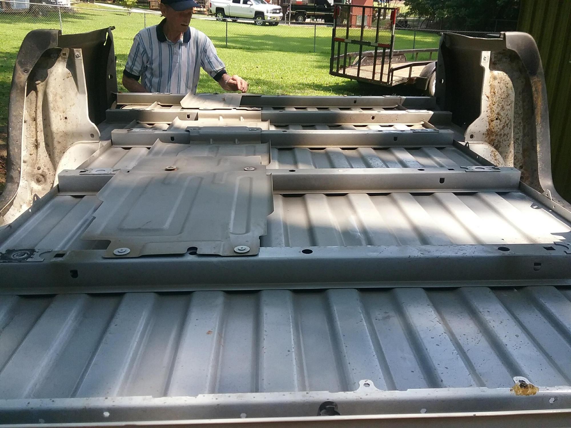

That is about what I started last week, I bought a 2017 GMC bed with damaged sides and good floor.
Hoping to do the same as you are describing.
How did you cut it?
Any advice or helpful tips are very welcome.

The ford is spot welded down the sides and then across the back and front, which I used a cheap set of step bits on. The final cut to shortened I used a zip disk in a 4.5" angle grinder.
That's really the easiest
D

What seam sealer to use down the two long seams
that just got welded?

Also what technique did you guys use to make sure the bed got back to the same level?
Did you use original crossmembers or the ones on the replacement bed ?

I haven't crossed that bridge yet, but you could use square or rectangular tube to accommodate each area, then use rubber pads to set height.

That was a thought also, I am thinking of using th crossmembers on the new bed floor where possible. I thought maybe notch them out to be as close to height needed and use rubber pads with steel or treated wood to get it right.

Don't use treated wood, it is extremely corrosive to steel.
https://galvanizeit.org/hot-dip-galv...h-treated-wood
