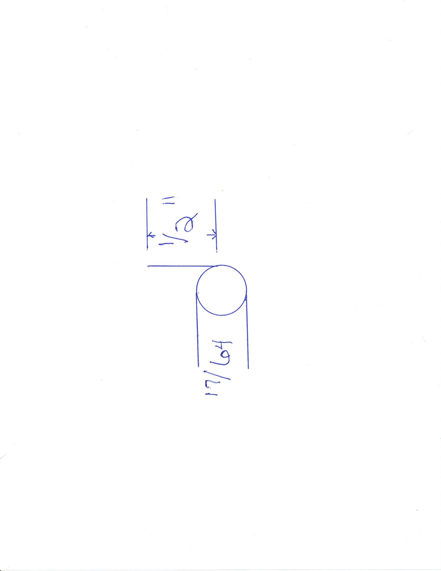

The seal on my 65 longbed is in sorry shape so the pic did not come out all that great and including a drawing that aint much better?

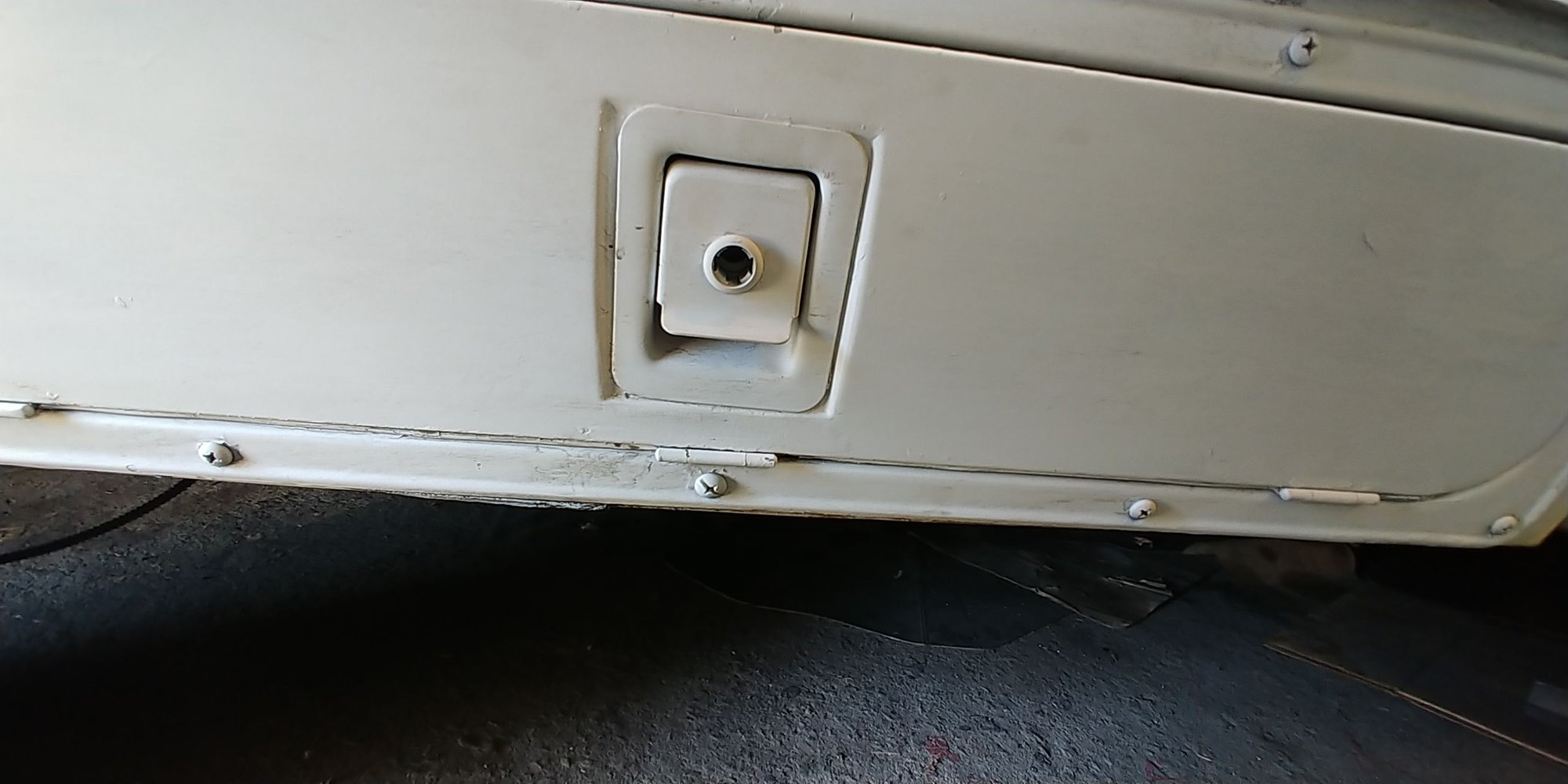

Hey guys the latch mechanism broke yesterday on my 1965 F250 long bed's curbside tool box. I'd like to just replace the entire latch mechanism as the lock cylinder was already gone anyway. I have been scouring the 'net but cannot find anyone who sells the latch. Anyone have a decent used one or know where I can buy a replacement?

Search for "Flush toolbox lock". Something like this isn't too far off appearance-wise. Not sure if the size is correct or not, but the seller might be able to help with dimensions.
https://www.ebay.com/itm/Flush-Lock-...8AAOxycERRjxSD

Thanks TA455HO I reached out to the seller to ask about the dimensions. I see some people call these "flush locks" and others "paddle locks". I have had a few trucks with this tool box in the past, didn't realize they are so hard to come by!

So the bulb is only 1/4" diameter? How do you think this would work. https://www.mcmaster.com/bulb-seal-weatherstripping

Taking into consideration measuring a piece of 55-year-old weathered rubber seal it appears a 1/4" drill is slightly larger fit in the bulb, and the total width measures 3/4" which includes the bulb and tail? I am not clear regarding the hardness rating, a slightly larger bulb may be okay if the material has some give??
I would look into the same type of flange seal measuring 3/4"x1/4"x1/4" and type of material of your choice? They also make a silicone foam variety but I do not think I would go that route; perhaps other members will chime in w/ their opinion? I posted a couple of examples for info purposes only.
The only other option I can offer is to mail a piece? The topic has come up before I like the link, seems much more info and choices.
High-Temperature Hollow Rubber Flange-Mount Seals: Hardness rating medium:
3/4" 1/4" 1/4" Durometer 55A Medium -100° to 480° Yes Salts, Water Black, Red 1, 5, 10, 20, 50, 100 1129A978 $3.68 $3.13
Water- and Weather-Resistant Hollow Rubber Flange-Mount Seals
3/4" 1/4" 1/4" Durometer 65A Hard -20° to 200° Yes Black 6, 12 1142A11 1.57

It's been a while since I took my box apart, maybe I even have a small piece of the original gasket. Also it's not that expensive, maybe I'll just order a 10' piece of 1/4" and 3/8".
