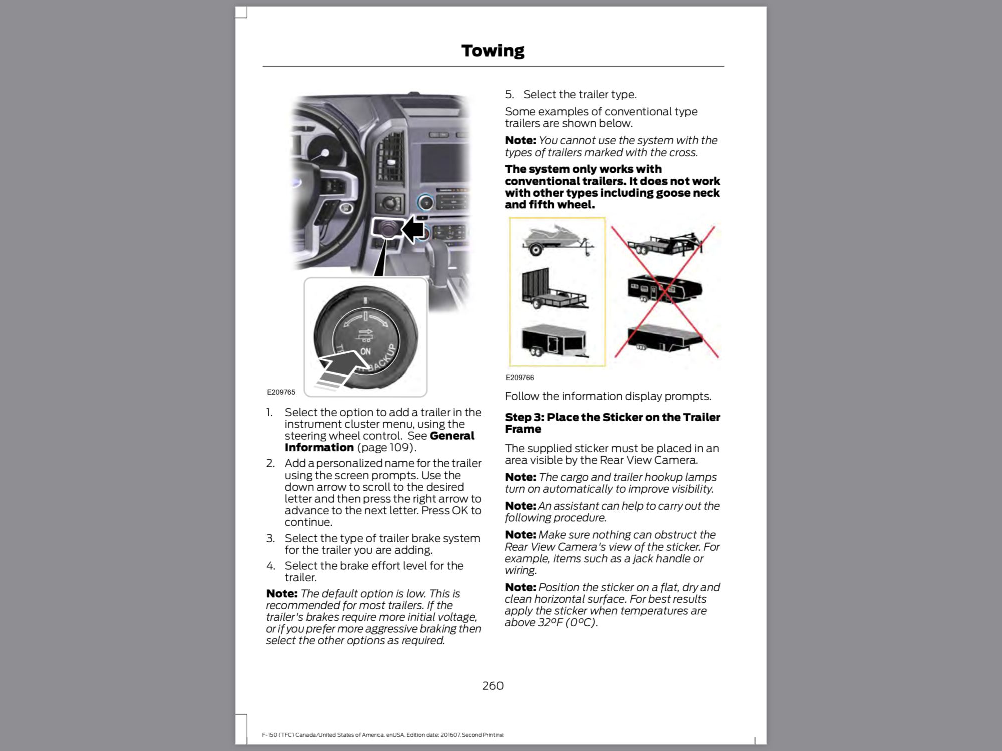

Originally Posted by rc1991
The system for the Super Duty is a bit different although the setup is the same. The Super Duty screen shows which way the trailer will go relative to wheel motion and when it will jacknife based on the display. I have a travel trailer but I believe there is some capability for 5th wheel with the system in the Super Duty. I do miss the Pro Trailer backup assist dial though that I had in the F150.
It's of no use with a fifth wheel, as the chart says. In fact, the only thing I have found of value to use with our fifth wheel is the camera mounted on the brake light on the back of the cab. It lets me see my hitch and the king pin on the trailer and has a centering line which lets me hit it perfectly every time. Best thing since sliced bread because otherwise I cannot see my hitch.
I also have a boat but have not set up the towing system with it. Maybe some day.
The chart is different for the Super Duty.....the sticker placement isn’t needed as it doesn’t work the same for a fifth wheel as far as showing trailer direction,etc. but it says you can use the various camera angles and split screen views. The F150 system didn’t have the split screen as far as I recall. If your towing a fifth wheel you probably don’t need all of that though since you are likely way more expert than me! 😀 I’m pretty new to towing so need all the help I can get!
