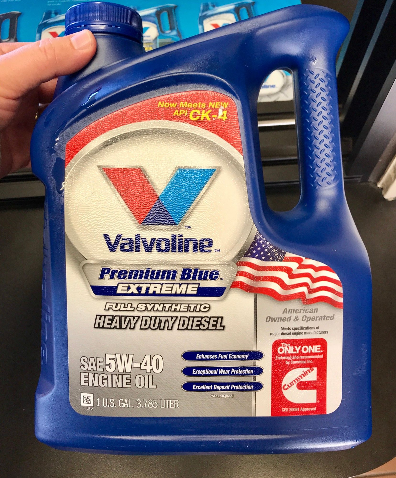

I run 5W40 Valvoline Premium Blue Extreme. It is on the list you linked to.

Valvoline Premium Blue Extreme 5w-40, unless of course you want to spring for the top-top shelf stuff like Redline and Amsoil.
^^^Ditto^^^

Just use a 5-40 to have all the bases covered. I currently use PBE but will use the t6 for the next few oil changes with it being on sale.
