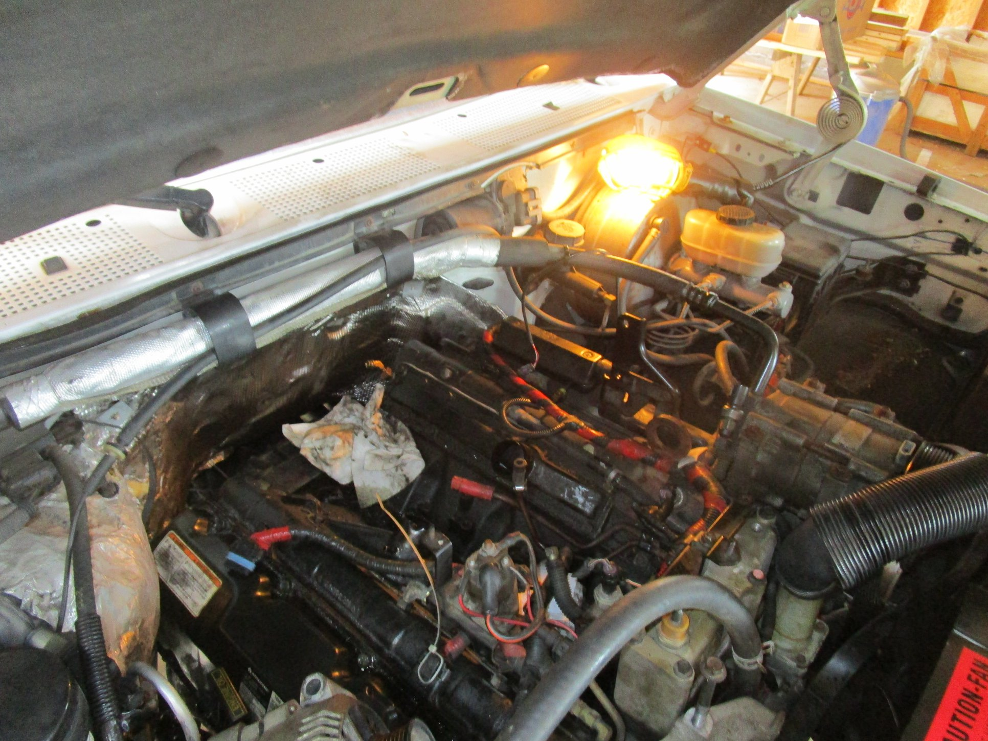

Old Jul 30, 2018 | 06:10 PM
dizzyfingers03's Avatar
dizzyfingers03
Joined: Feb 2011
Posts: 462
Likes: 13
From: Lovettsville, VA
I put the GM mirrors on a while back, very nice upgrade to these old trucks.
All stripped out.
Filthy, but finished.
