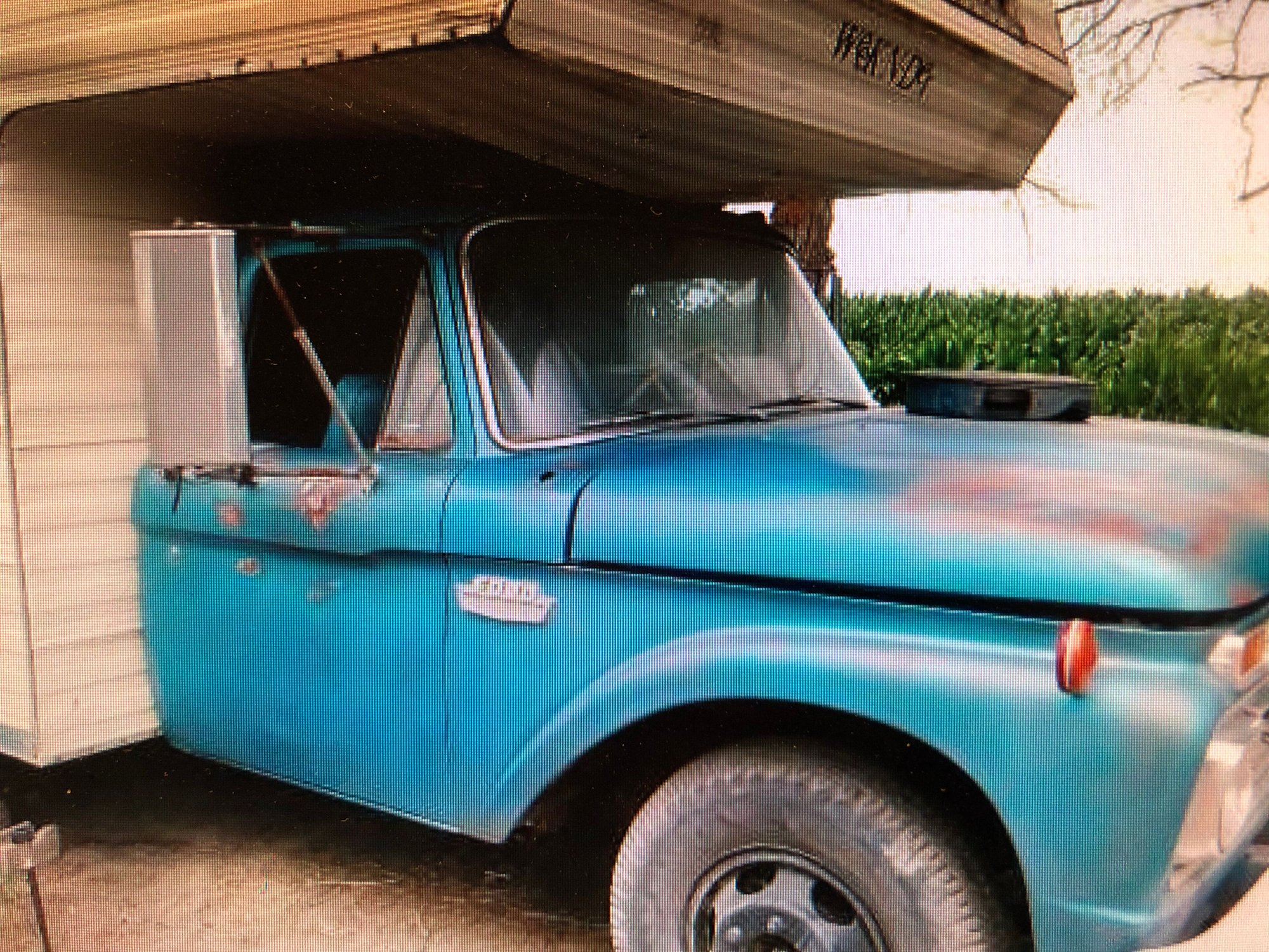

Looking at a 66 F350 cab Chassis with a camper on the back that looks factory.

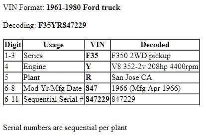

This may help until someone else can give you the whole story...

The V.I.N. format above is not accurate entirely to the 61-66 years. F35 does not decode to pickup, it only decodes to 1 ton. It could be a pickup or cab and chassis or even just a cowl on a frame.
Colour = WM - w is Marlin blue and M is Wimbledon White
Trans = A - NP435 4spd
DSO is special order as it is 6 digits long. 74 is Seattle I believe
I am sorry I do not know what the 22 rearend ratio is as my books are buried.

It is a cab chassis. Here's another photo. I don't have any showing the rear half but I'm assuming its a dully with a longer wheel base than a regular truck.
F35 = F350 (does not decode to pickup!).
Y = 352 2V (does not decode to gross HP/RPM).
R = San Jose CA Assembly Plant.
847229 = 1966.
Wheelbase: Blank.
WM: W = Marlin Blue / M = Wimbledon White.
F350, 10000 lbs. GVWR
B81: B = Medium Blue Crush Vinyl & Medium Blue Cody Pattern Woven Plastic / 81 = 81B Custom Cab.
A = New Process 435 4 Speed Manual Transmission.
22 = Dana 70 Rear Axle / 4.83-1 / 7,400 lbs. Axle Capacity.
10,000 lbs. Gross Vehicle Weight Rating.
172 net HP @ 4,000 RPM
740637:
74 = Seattle WA Ford District Sales Office, where the original selling dealer ordered the truck from.
0637 = Domestic Special Order number, truck ordcered special by the original purchaser, not "bought off the lot."
The reason for the 6 digit DSO probably has to do with no wheelbase stamped on the Warranty Plate. It's possible that FoMoCo stretched the frame so the camper would bolt to it.
