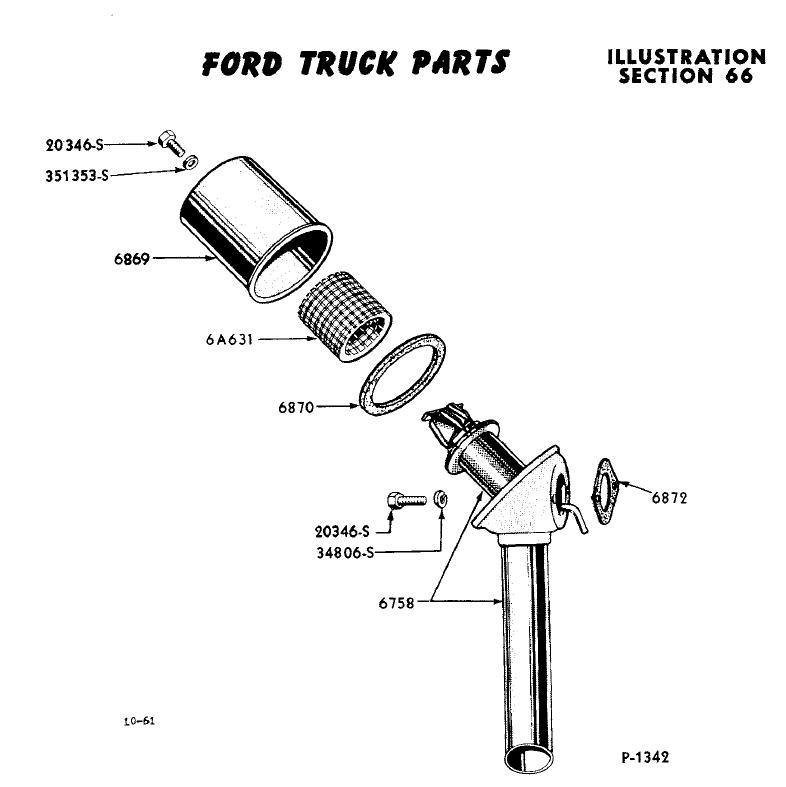

Thank you all for the quick responses. Going by pictures it is a road draft tube. The reason I was asking if I could connect it to the back of the carb I thought it was a pcv valve. After running my y block i notice it drips oil. Maybe the filter inside is clogged? Does anyone know if I can replace this filter? Or gasket?
Thanks
Jerry

Those "Vacuum Crankcase Ventilation Device" can be disassembled and cleaned. Usually when the road draft tube starts dripping oil it indicates a worn engine and lots of blowby. This is the same road draft tube that I remember spewing oil and blowing oil smoke onto the pavement when the vehicle was climbing a hill. The crankcase would build pressure from blowby and the oil and oil fumes would blow out onto the road. Any lightly colored road of old always had black marks in the center of the lane where this oil would be deposited.

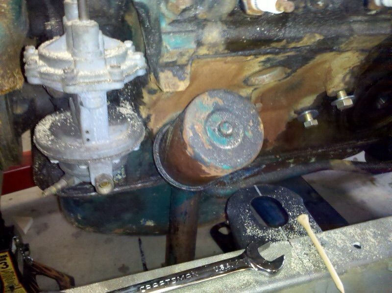

Old Jul 21, 2018 | 01:05 PM
Thanks
Jerry
This is a regular maintenance item. I think it needs to be serviced at every oil change, not sure about that (I forgot). The filter just needs to be cleaned, and if it's dripping oil then most likely the little oil return tube is plugged from lack of maintenance, or the unit is overwhelmed by an oil burning engine. The assembly will have to be removed from the engine and thoroughly cleaned.
B2TZ-6A631-A .. Crankcase Ventilation Screen / Obsolete
B7A-6870-A .. Crankcase Ventilation Cover Gasket / Obsolete
1952/59 239/256/272/279/292/317 Y blocks.
GREEN SALES CO. in Cincinnati OH has 33 screens, 13 gaskets = 800-543-4959.
